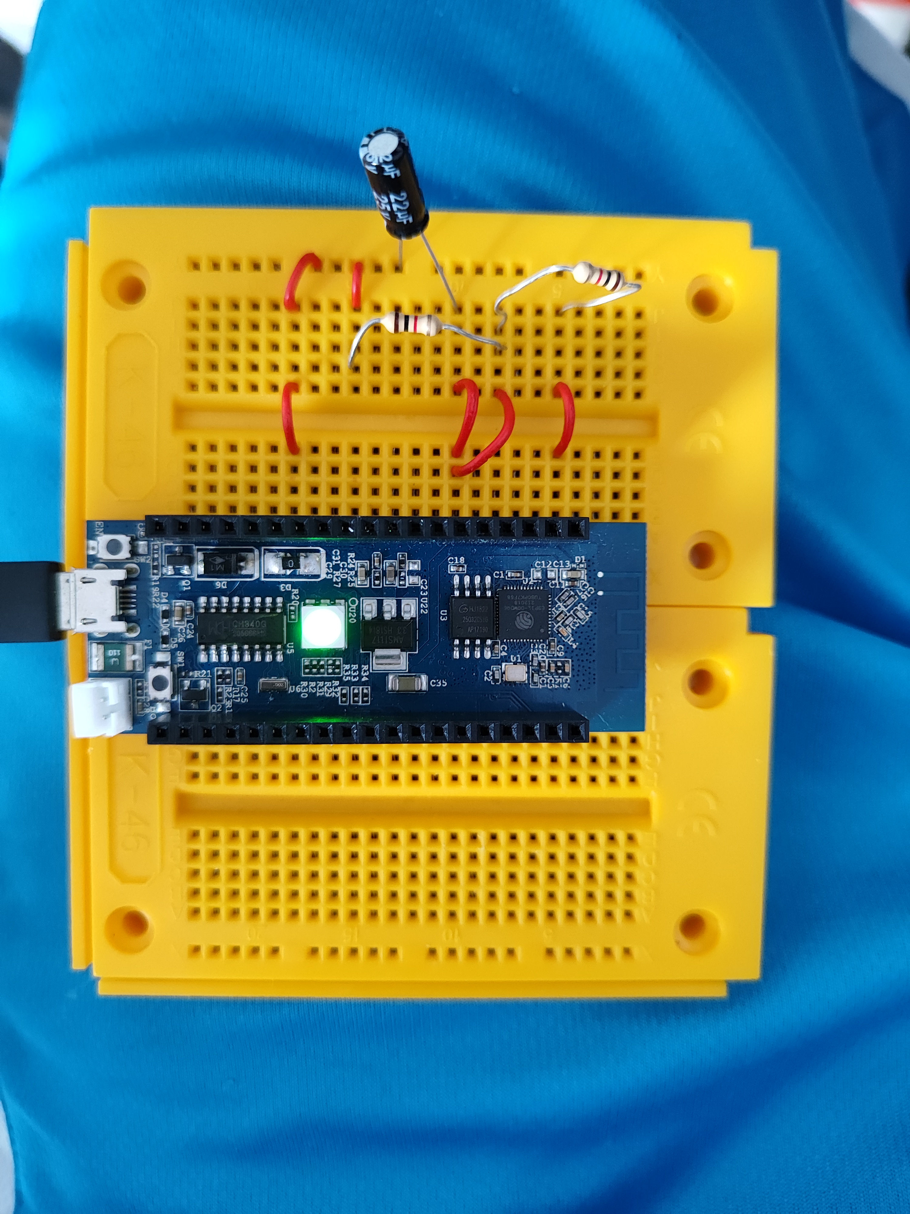

Hello everyone,
so I have been experimenting with an ESP32, building a simple voltage divider to test the ADC.
As i have been using R1 = R2 = 1000 Ohm I was expecting to read 1.65V or a data value of 4096/2 = 2048.
However I am just reading ~1700 which corresponds to ~1.36 V.
I checked this with a multimeter too, where i received exactly what i was expecting, 1.65 V.
I even added a capacitor as i read that that could help with false readings, but that didn't change anything
What could be the issue here? Code below and image from the board

Postby Sprite » Mon Jul 31, 2023 12:30 am
You are assuming the ADC uses a reference voltage of 3.3V. This is not the case; it uses around 1.1V but it has internal attenuators that allow you to measure higher ranges than that. I don't exactly know how that works on an Arduino level, though.

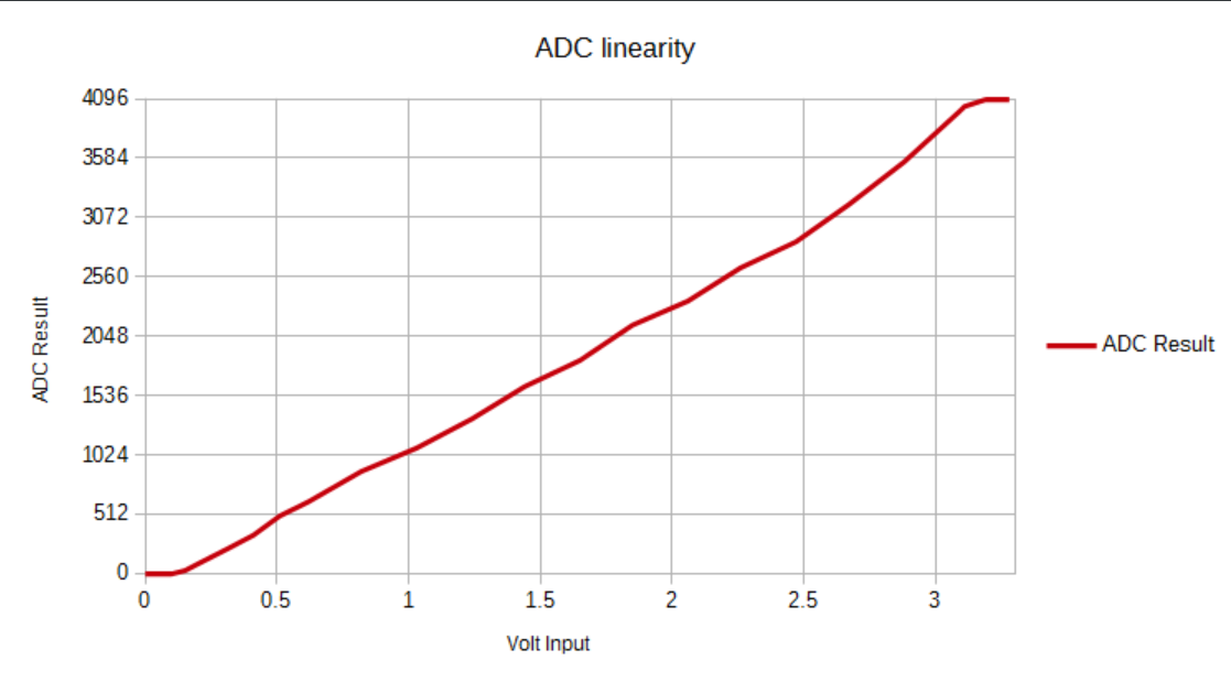

Postby Skyscraper1450 » Mon Jul 31, 2023 7:56 am
You are right I did assume that. However i found this image which confirms that the voltage range is 3.3 V. Maybe it can also explain the error that im facing, in which case the "wrong" reading is related to the non linearity of the ADC. I have heard of the non-linearity of ADCs before, but i had no idea it could be this severe
