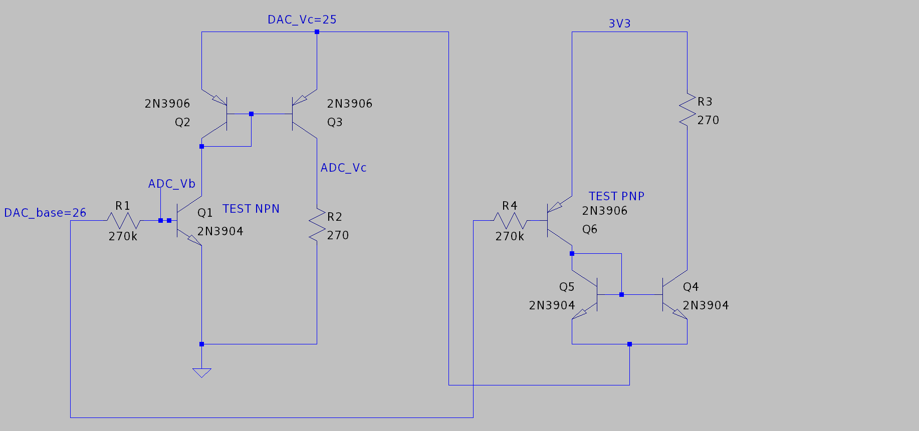

There are several 'simple' solutions and schematics to be found on the net. What you need is a staircase Base current input and a sawtooth Uce Voltage. How convenient that the ESP32 has two DAC's readily available. The Collector-Emitter Voltage over the transistor under test is stepped from 0 to max Voltage (3V3) and we need 5 Base currents stepped up from e.g 0 to 10uA.
The Transistor under test is coupled through a current mirror and the current is fed to a 270E resistance. Note the similarity between the NPN and PNP measurement.

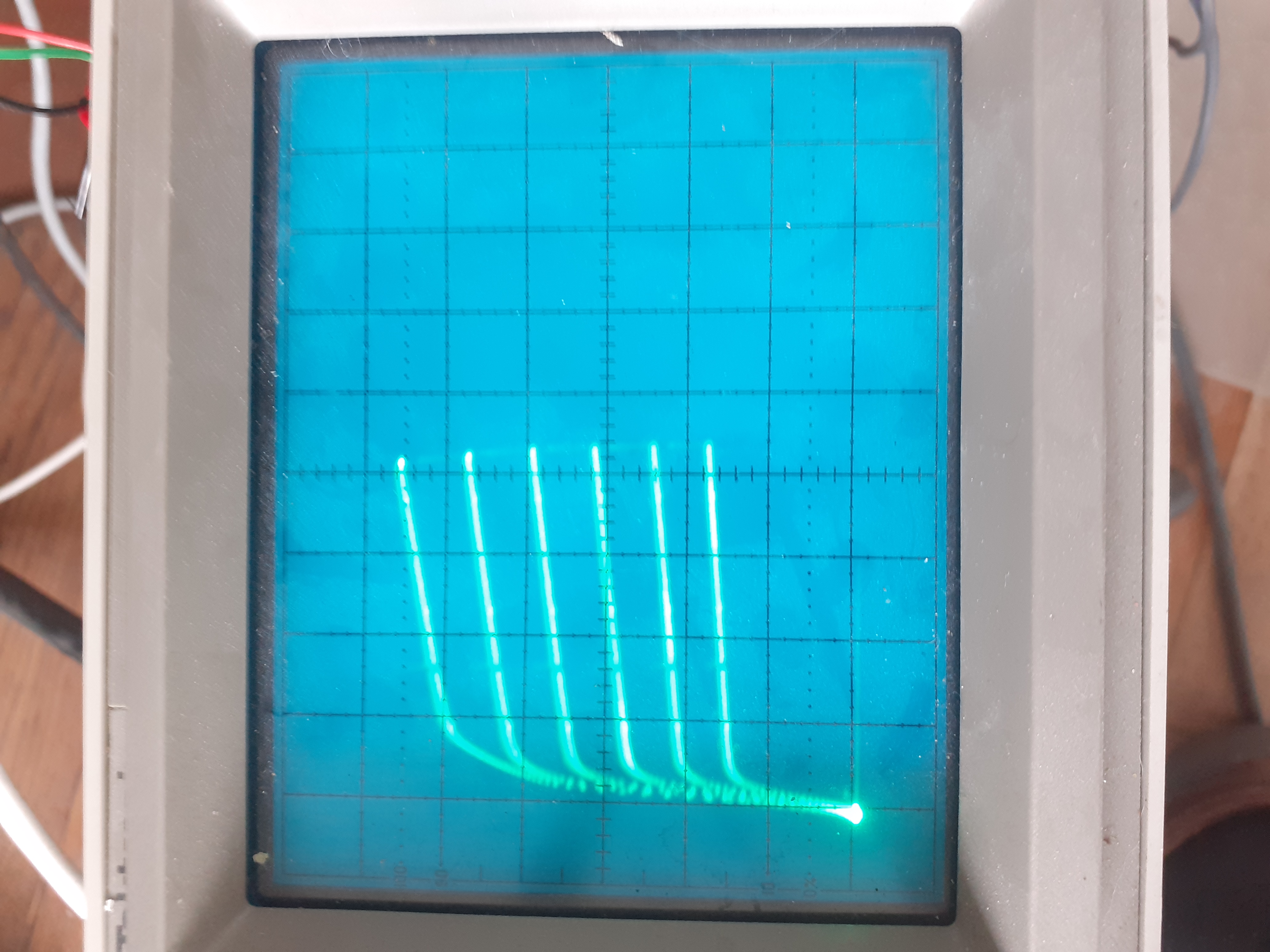

You will need a oscilloscope with XY mode to output the characteristics.
The X probe is connected to the Collector of the NPN, the Y probe to the 270E resistance.

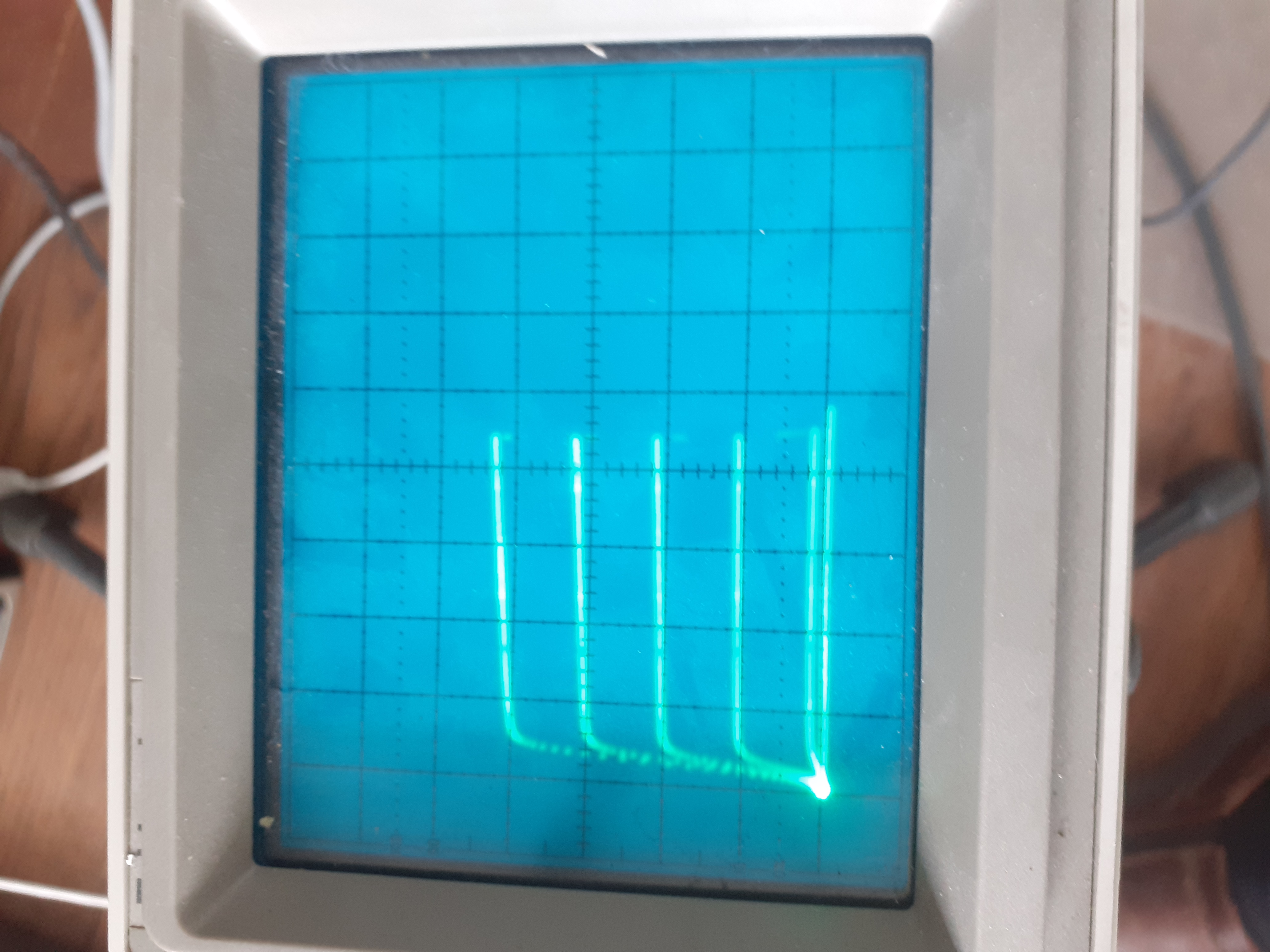

For a standard 2N3904:
Note that Y-axis is now 0.2V/div.
Leakage is pretty high, even for a Germanium BJT: 380mV/270E = 1.4mA (up to 300uA is acceptable, this transistor is not good)
I only tried this with NPN sofar, will setup the experiment for PNP as well later.
