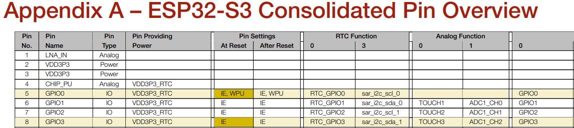

Bonus question about pin assignments, which may well be in the TRM;
This appendix from the ESP32-S3 Datasheet shows GPIO0/1/2/3 are enabled for I2C using the ULP.
https://www.espressif.com/sites/default ... 00,1046,76
Would I be able to use GPIO1 and GPIO2 as an I2C pair, leaving GPIO0 and GPIO3 free for bootstrapping?
Or can you suggest another way to use I2C in DeepSleep?
(or have I misunderstood something?)
Many thanks, and Kind Regards,
Ben

Re: Pin Function/ Descriptions
Hi Ben,
Yes you can use GPIO1 as the SDA pin and GPIO2 as the SCL pin when using the ULP I2C. You would need to update the i2c_pin_cfg when initializing the ULP I2C - https://github.com/espressif/esp-idf/bl ... _i2c.h#L44
