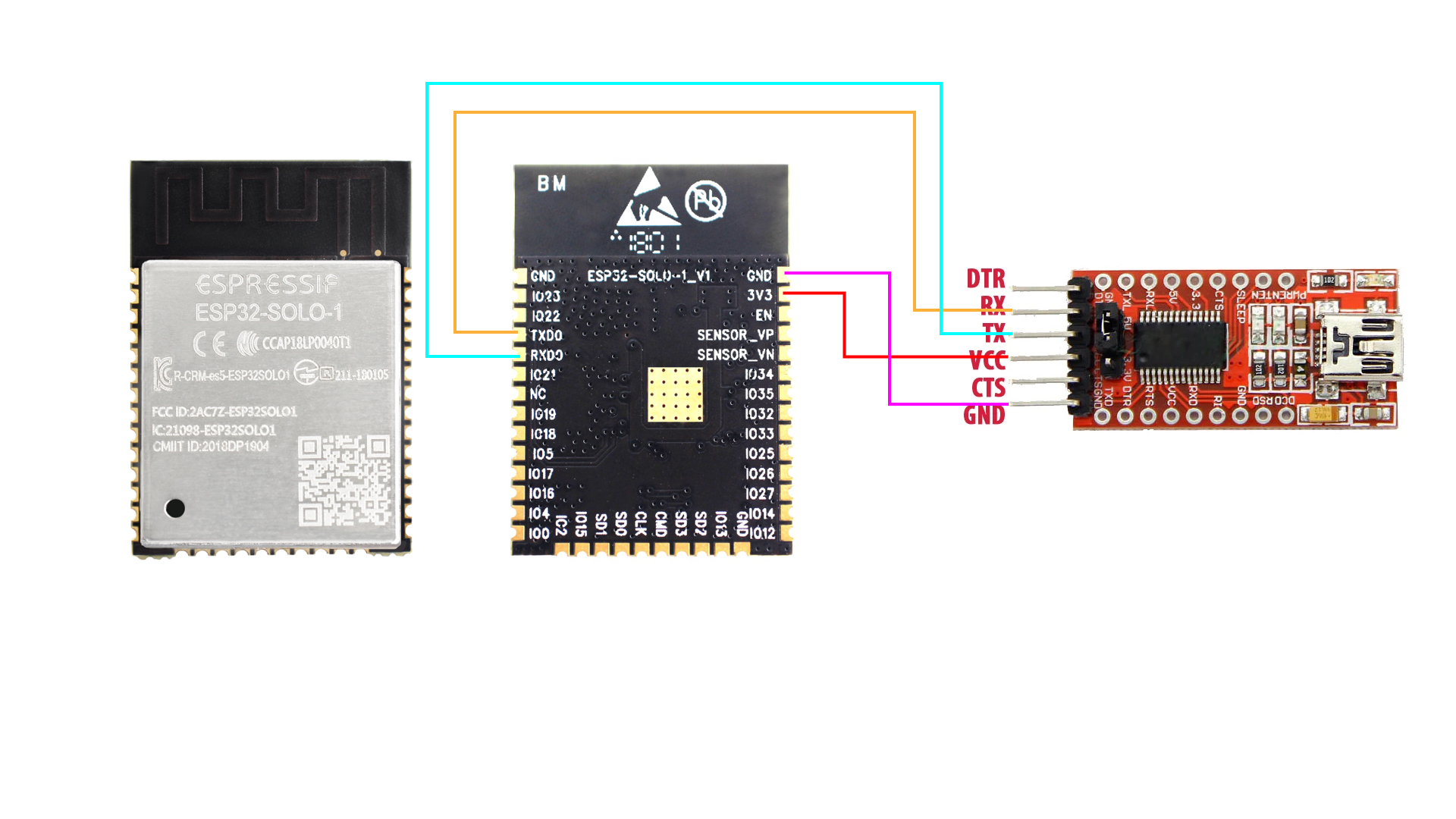

Can I compile the esp32 solo module without using the development kit?
Oğuzhan
Joined: Mon Aug 28, 2023 10:50 am
Postby Oğuzhan » Mon Aug 28, 2023 12:53 pm
I get an error when I connect as in the picture below.
Where am I doing wrong?
Çalışma Yüzeyi 1.png (1.09 MiB) Viewed 1206 times
Posts: 10618
Re: Can I compile the esp32 solo module without using the development kit?
Postby Sprite » Tue Aug 29, 2023 12:12 am
- That board is unlikely to be capable of powering an ESP32. Try a power supply that can supply at least 3.3V.
- You also need to connect the strapping pins as well as EN. See the datasheet for more info.
