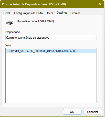

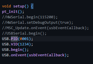

I tried again following your instructions but it didn't work. I've attached screenshots so you can check. The device keeps showing up as a COM port and with another VID

I started from the USBSerial example. Directly after the HWSerial initialization, I added the lines for VID and PID (before any other USB calls). Make sure the board settings are USB Mode: USB OTG, disable USB-CDC on boot, and upload mode is USB OTG.

Rereading your post, everything is working for you. VIDs are hex numbers, I recommend you use a 0x for your numbers. 1234 = 0x04D2
