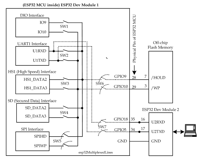

In the pinout diagram of my 30-pin ESP32 Dev Module, only UART2 Port is free. I need to use UART1 Port. Data sheet shows that the IO lines of this port are associated with physical pin-28/29 (GPIO9/10) of ESP32 MCU). Currently, PPin-28/29 of ESP32 MCU are engaged with flash memory. The following code allows me to connect the IO pins of UART1 Port with GPIO5/18. Does Espressif agree with this relocation and do they support it to use in commercial applications?
Code: Untitled.cpp Select all
Serial1.begin(115200, SERIAL_8N1, 5, 18);

Assuming this is a 'classic' ESP32 (not S2/3 or C2/3/6/...) as you didn't specify otherwise: those GPIOs are free and this should work.

It is 30-pin ESP32 Board and comes as ESP32 Dev Module in Boards List. At the back of the board, there is a laser engraving: ESP32S. The propsed UAR1(5, 18) communicates well with UART2(16, 17) of another ESP32S.
Thank you for the answer.
