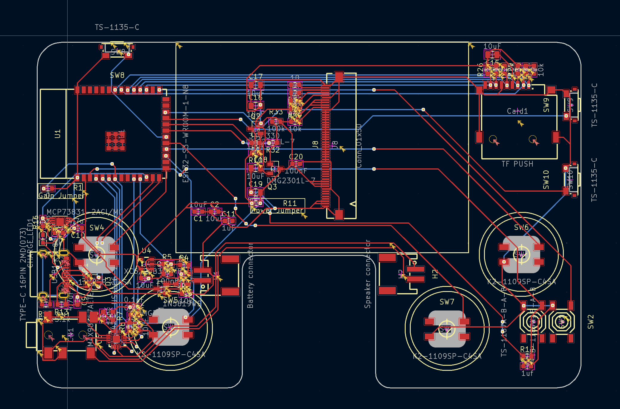

Thanks a million for your explanations, I waited a bit to post again here mainly due to the high moderation times. I have been making some tweaks to the board:
- removed d3
- removed the rotary and went for switches instead
- added some capacitors for the esp32 s3 - I just saw that on a feather board, does that make sense ?
- Changed the resistor around the battery level to a 1M - it's been recommended to me as drawing less current while achieving the same result. Would you agree ?
And some other tweaks.
The new schematics are attached - If you still have a minute to take a quick look, I’d be thankful for some feedback to any big mistakes.
I am not sure actually what was the color of the LED in the original design. Moving to a blue one would make good sense for the user experience, what should I be careful about when choosing this path ?
I am preparing to move to production, and have been designing PCB and tracks (attaching an image of this). On this, one question comes to mind - should I use bigger tracks for the current paths or is that more or less fine to use the default track size for everything ?
Also on capacitors - the one used for stabilizing current, is there a physical placement required, or can they be pretty much anywhere on the PCB ? (this might come as a very stupid question, but I am being candid).
Finally, some parts recommendation:
- Does anyone have a battery/speaker connector to recommend that would have a slimmer profile than this pretty big jst PH2 that I am using ?
- The cheaper the best - as I’ll be connecting to the wifi, playing mp3s and diplaying static images (bitmap or jpeg) on the tft screen, i wouldn’t describe this project as resource intensive. Should I consider an S2 or even a C3 for the mcu, rather than the s3?
Thanks again for the support I found here, this is really empowering me on this first experience!
