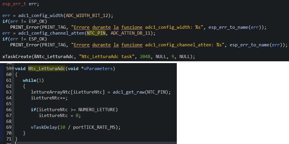

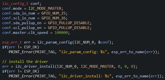

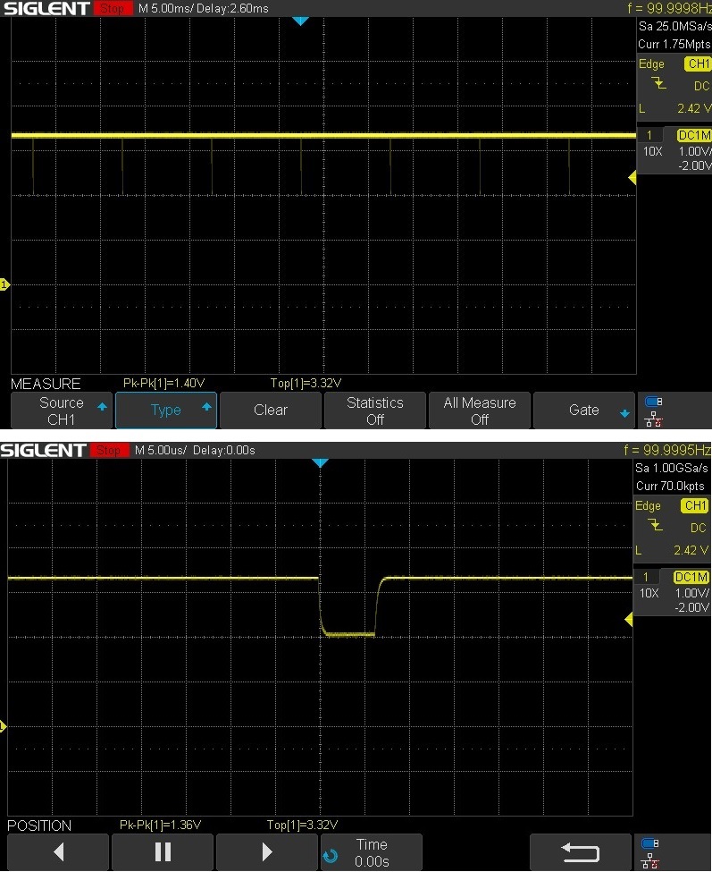

I've developed a custom board which integrate an ESP32-WROVER-IE. During the PCB testing I noticed a noise in the I2C bus. The noise seems to be correlated to ADC acquisitions. I would like to find out what's the cause of this phenomenon and possibly solve it.
For simplicity, I replicated the same behavior by using an ESP32-DevKitC-32UE and activating only I2C and ADC peripherals.
For this purpose I've used the following pins:
- IO25 --> SDA
- IO26 --> SCL
- IO34 --> ANALOG INPUT
Here below I'm adding some code screenshots.
I2C setup
ADC setup and periodic task (ADC acquisition)
The noise on the I2C bus seems to be synchronous to the periodic task.
Hardware-side, the only things I've added to the ESP32-DevKitC-32UE were two 10k pullup resistor between SDA/SCL and +3V3 supply.
The following images are some oscilloscope captures that highlight the noise present in the I2C bus. Specifically, the oscilloscope probe was placed between the SDA and GND lines:
Oscilloscope acquisitions
Have any of you encountered the phenomenon I described?
