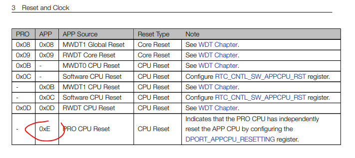

I have never encountered these values while doing tests so I was wondering if you can help me identify what 3, Software reset digital core mean first ?

I found in technical manual the following

What you observed seems to align with esp_restart_noos().
In your case, esp_restart_noos() seems to have been called on the PRO CPU (core0) so that the PRO CPU first forced a reset of the APP CPU (core1) before resetting itself.
If your application didn't intentionally cause a restart, esp_restart_noos() may have been called by the panic handler.
