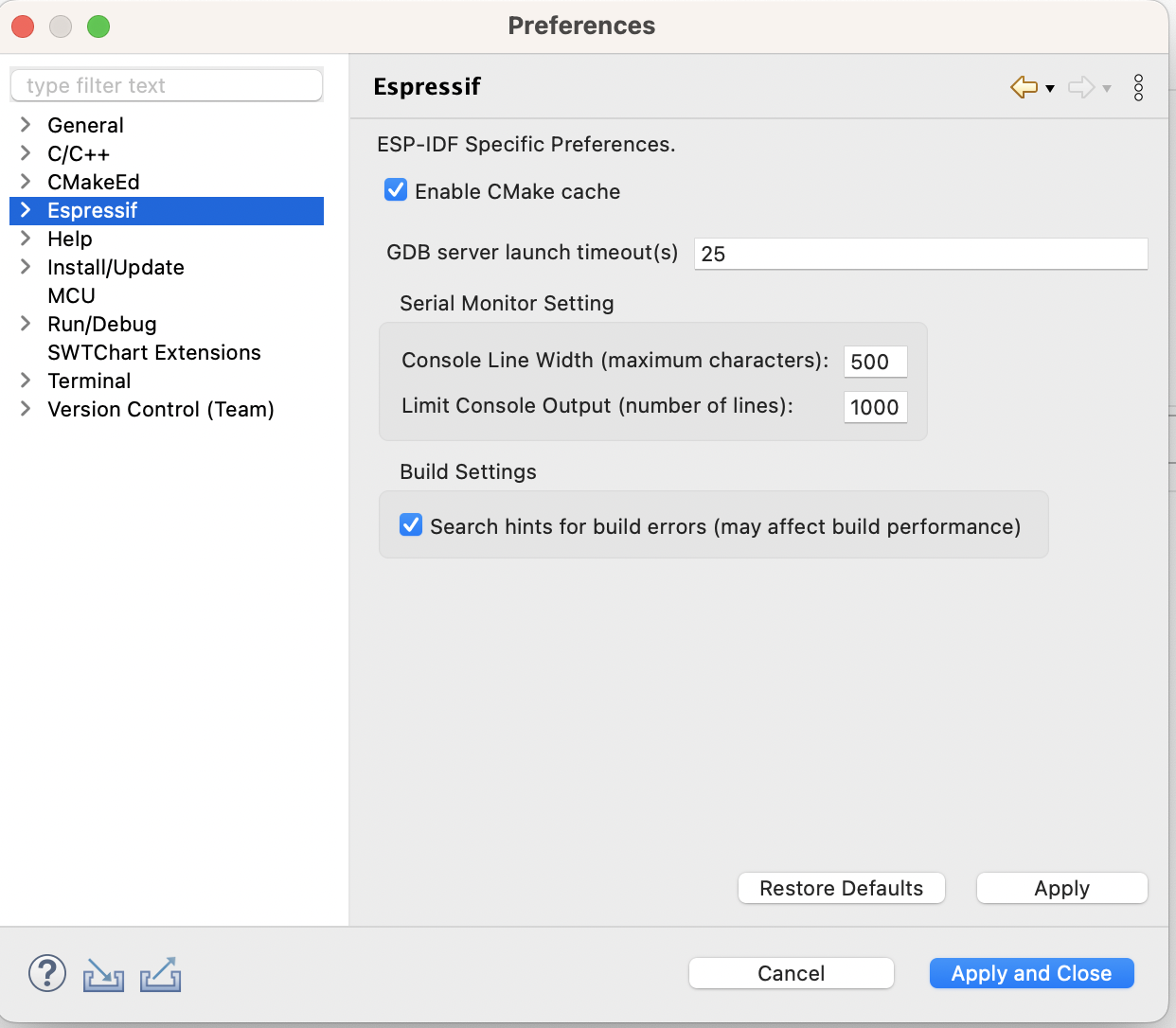

Postby Cambeast » Sat Oct 07, 2023 11:53 pm
I have been trying to start a debug session for my ESP32-DevkitC v4 board in the most recent Espressif-IDE version.
The DevKit I have contains a ESP-WROOM-32-DA.
I am able to start a debug session using OpenOCD and ESP-IDF from the command line, but I cannot successfully get one to start from a debug configuration within Espressif-IDE.
Has anyone had any success with creating a debug session for this board with a J-Link, and is this even a possibility in Espressif-IDE? I ask because within the Debug Configurations dialog, there is a selection box with other targets/hardware interfaces to select from, but I have to edit the config options to use "-f interface/jlink.cfg" interface because none of the available options matches my configuration. This may be incompatible and cause issues in the Espressif-IDE. Can anyone confirm this is my problem?
I am trying to use a J-Link V11 since I have one sitting around, but I am open to purchasing an FTDI 2232H or ESP_Prog board if necessary. But before I do so, I would like to confirm that my issue is with trying to use the J-Link and that one of these tools would actually work.
If I purchase an ESP_PROG board, would the appropriate board selection option in the Debug configuration settings be: ESP32 chip (via ESP-PROG)?
Also, I am able to flash the ESP32 using the J-Link from the Espressif-IDE, using the same options as when trying to debug (Selecting ESP32 chip (via ESP-PROG), but changing the interface to use jlink.cfg in the config options) and I get a successful (albeit very slow) flash.
More about my error:
In case I should actually be able to use a J-Link from within Espressif-IDE, I'll detail more about the error I am seeing.
Basically when I click debug, nothing happens. The OpenOCD server fails to start, with a "Starting OpenOCD timed out" error. Looking into the 'Starting OpenOCD" diaglog, I have this internal error:
An internal error occurred during: "Starting OpenOCD".
RequestMonitor: Sequence "", result for executing step #1 = Status ERROR: org.eclipse.cdt.dsf code=10005 Request for monitor: 'RequestMonitor (org.eclipse.embedcdt.debug.gdbjtag.core.dsf.GnuMcuGdbServerBackend$GdbServerStep$1@4ece417b): Status OK: unknown code=0 OK' resulted in a rejected execution exception., done() method called more than once

I have also tried starting the OpenOCD server from the command line, and then de-selecting the 'Start OpenOCD locally' option, to see if I can start a gdb session if I off-load the server setup from Espressif-IDE.
When I try this, I seem to almost get a successful connection. But OpenOCD rejects the GDB connection on port 3333, and attempts to listen on 3334 instead. I'm not sure what is happening here. I thought it may have something to do with Firewall settings, but not sure.
From the command line:
C:\Espressif\frameworks\esp-idf-v4.4.5>openocd -f interface/jlink.cfg -f target/esp32.cfg -c "adapter speed 100"

From Espressif-IDE error dialog:
rror in final launch sequence
Failed to execute MI command:
-target-select remote localhost:3334
Error message from debugger back end:
localhost:3334: Connection timed out.

> !MESSAGE Starting OpenOCD timed out.
I apologize for the delayed response. I don't have a J-Link to verify this scenario. However, could you try increasing the OpenOCD server timeout and see if that helps?
You can find this option in the IDE preferences > Espressif > GDB server launch timeout
Screenshot 2023-11-01 at 11.52.42 AM.png (456.56 KiB) Viewed 46826 times
