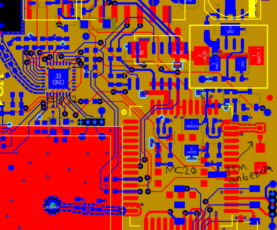

I have designed an iot device using esp32-c3 and quactel mc20 module.
I have a big problem!
When the mc20 module is without a SIM card, the esp32 continues to work without problems. But when the SIM card is placed on the device, after a few seconds esp32-c3 starts to reset with a cycle of approximately 3-4 seconds.
When I search for the reset reason with the esp_reset_reason() function, it returns 0.
Interestingly, if I remove the crystal bypass capacitors, the situation will improve (10pf), but after a while, this problem occurs again.
One more thing, when I put my hand on the esp32-c3 crystal, the device resets!
The designed board is 4 layers.
thanks for your help

Possibly a power issue? I know that GSM modules can use a pretty large burst of power while making a connection; could be that something is browning out.

I checked the power supply with an oscilloscope, there is no change, even if browning out, it should write the reason for the reset.
The important point here is that by removing the crystal capacitors, this problem will be fixed to some extent.
Only when we don't have crystal capacitors, Bluetooth doesn't work!

Do you have serial logs? Can you post them? Also, can you post the schematic?

Really, no way to even solder a wire to the 499R resistor on U0TXD and get the logs from there?
Do you have C29 installed? If not, you could try to install that, see if it makes a difference.

It is not possible to install C29, because it is masked inside the schematic and not inside the pcb, if you doubt it, I will install it manually.

hi,I added the capacitor but it didn't make a difference, I was able to get a better log and I realized that the cause of the reset was GLITCH_RTC_RST. Do you have a solution for this error?

Ooh, that's the clock glitch detector. Means something is wrong with the (crystal) clock signal going into the ESP32. Potentially something from the GSM module is being coupled into the clock traces? You could also try disabling the glitch reset functionality by setting a bit in RTC_CNTL_ANA_CONF_REG (see the C3 TRM), that might be worth trying just to see if there are issues elsewhere.

Yes, I came to this conclusion, I will definitely test this item today, I have a lot of doubts about the crystal capacitors, so I will test it today.
