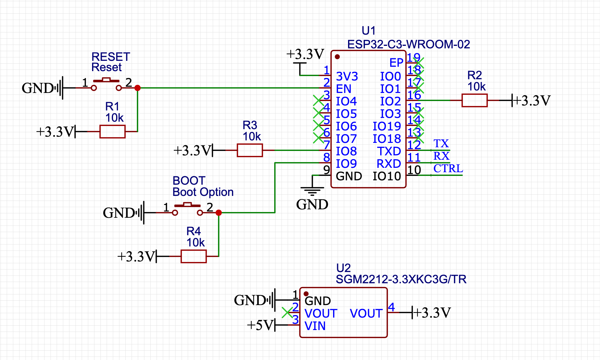

Dear ESP32 forum,
I just designed a PCB as per the esp32-c3-wroom-02_datasheet here https://www.espressif.com/sites/default ... eet_en.pdf:
Everytime I try to connect to WiFi, it restarts with reset reason POWERON, I think it's very strange. The very first time I used a AMS1117-3.3 for power supply. After some googling, it told me that the reset reason is insufficient current, now I changed it to SGM2212-3.3XKC3G/TR, which is used by the official DevKit here: https://dl.espressif.com/dl/schematics/ ... 00915A.pdf. But the problem persists. Two days of investigating, I still don't know why.
Notice line no. 88 and 145, the time I connect to WiFi, it resets (POWERON, not software reset or brownout reset, etc. how could it be?):

I'm new to hardware design, anything could be helpful, Thanks.

Postby Sprite » Tue Nov 07, 2023 4:43 pm
If any, you're missing a capacitor (1uF or so) from the EN line to ground. I'd add that to the PCB if I were you, but I don't think that's the issue here.
Are you sure this is a hardware problem? As in does the firmware not crash if you program it into a known-good board like a devkit?

Postby momothepeach » Wed Nov 08, 2023 7:30 am
@ESP_Sprite Thank you for your reply. I can be sure it's not a software problem, because it happens only when the time I connect to WiFi. And it will now happen on a official DevKit board.
For the capacitor, I carefully compared my PCB board with the official Peripheral Schematics, https://www.espressif.com/sites/default ... #section.6, some capacitors were missing. After adding them, my board can now connect to WiFi without resets.
But, it's not very stable (as in disconnecting...reconnecting...disconecting...reconnecting). This board is actually a Switch (for controlling light bulb on the roof), I'm using a Transformer to convert the AC to DC 5V, and then a LDO to 3.3V. And a Relay. Will the transformer and Relay make some impacts on the ESP32 RF?

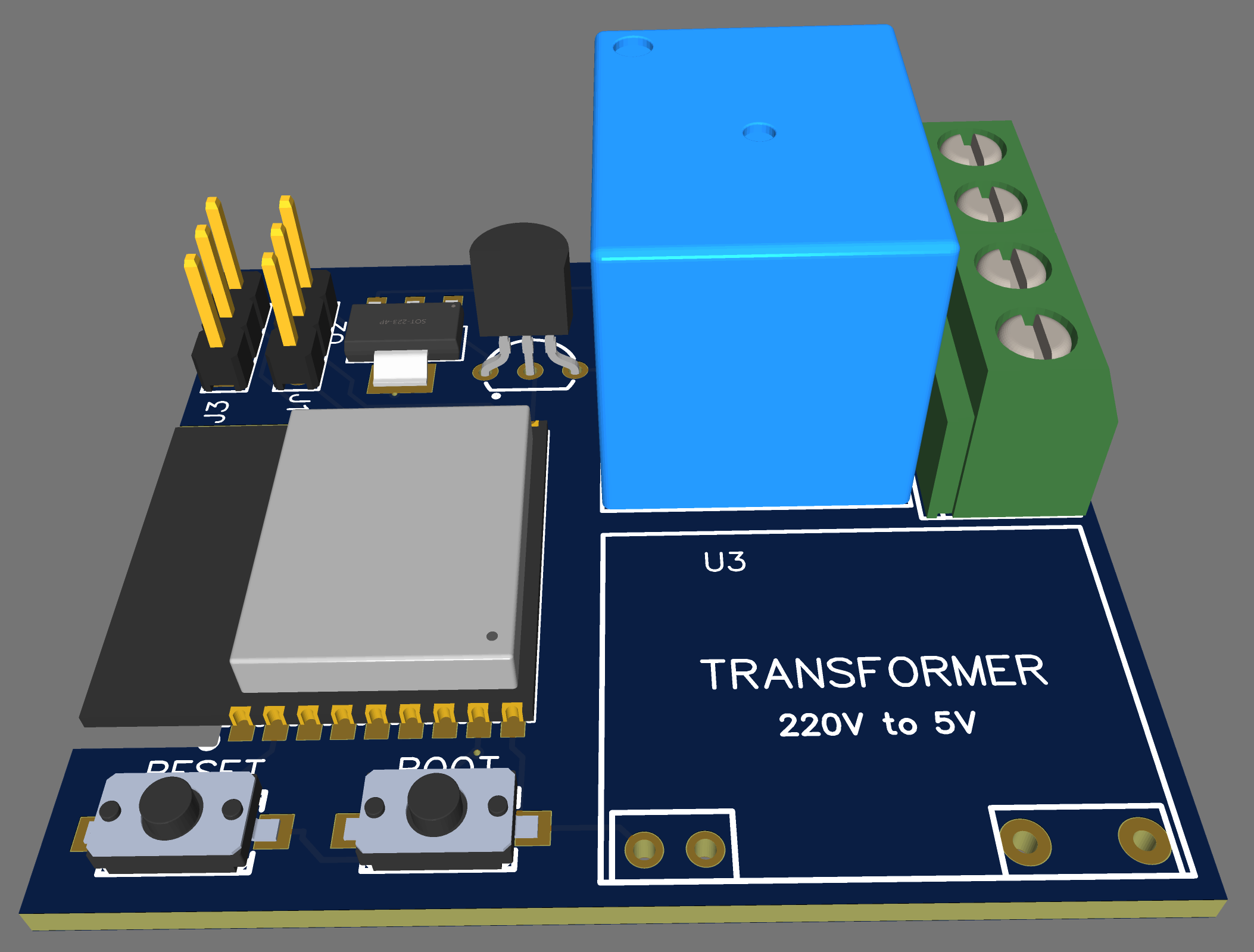

It could have. I'm not gonna pretend I know a lot about RF magic, but having large chunks of metal close to the ESP32 probably isn't good for RF performance, and depending on your PCB layout you could have issues with RF from the mains getting to your ESP.

Postby RandomInternetGuy » Sun Jun 09, 2024 11:04 am
It's not the actual question, but when the magnetic field in your relay collapses and it needs to dump many tens/hundreds of volts into a spike somewhere, where does that go? It's possible this board handles it, but I don't see the requisite parts. Stick a scope with a trigger on the trailing edge of your transistor activation and another channel on the coil and watch the voltage spike as the coil deactivates. This is electrodynamics at work. :?
Also, just from a cost/serviceability/heat dissipation view, having a chunky transformer millimeters from an MCU (especially one with radios in it) probably isn't very awesome. Power supplies are usually on different PCBs for a good reason. Take apart ten pieces of tech in your house and count the number of PCBs that physically look like this.
There may be a parlance problem, but the output of a transformer is AC. Your board doesn't contain an obvious rectifier/filtering stage. Next, aim your scope at your DC 3.3V and see if it's as clean across reconnections as you think it is. It doesn't take a lot of ripple to turn into reboots.
Hint: All these are well discussed on the web and none of this is actually specific to this MCU.
If you're so sure this is a problem with Espressif's own hardware and not your code, please post a reproducible, self-contained example that demonstrates it. That'll make it easier for others to help reproduce it If it happens only after you've surrounded Espressif's board with your own hardware, you'll have a clearer answer. I suspect that after you eliminate the two coils you'll find that Espressif's reference modules do not, in fact, reboot when "reconnecting", whether that definition means either the board connecting to the upstream WiFI carrier or to the remote triggering source that build a connection to cause the light to toggle. There are simply too many of these in use around the world doing this very thing, including often inside light bulbs themselves.
I'm a mere software guy, but the EMI on this board looks worth questioning.

Postby eriksl » Tue Jun 11, 2024 10:05 am
Besides this also another important point: the power supply. This should be really good, or expect to have problems. An ESP is a not a light bulb. When you start using wifi actively, the power use will raise significantly. If the power supply isn't up to it, the module will have trouble associating. Or worse, the brownout detector will kick in and reset the chip. This is probably what you're seeing. Most of the time the power supply will actually be able to supply enough power, but not quick enough. This is where you add not one but two capacitors as close as possible to the ESP. One large electrolytic (1 uF will probably do, but more is better) and one smaller ceramic or other quick-responding type (like Mylar etc.). A value of 100 nF will do most of the time. The second capacitor will serve two goals: firstly it will protect the first capacitor from high frequency noise, which electrolytic capacitors don't like (has a negative impact on their lifespan) but secondly, they will respond far more quickly to voltage variation, which for, especially an RF device, is crucial. You don't want any high frequency noise to end up in the RF signal.
Besides that, I'd recommend adding a 100 nF ceramic capacitor directly to the EN pin, so any (short) power variations will not lightly change the state of the pin. Believe me, since I practice this, I've had a lot less crashes due to TL lights in the neighbourhood being switched etc. As you're using a "hard" (mechanic) switch, it's recommend to also add a resistor in series with this capacitor, because otherwise the capacitor may dump it's charge in one go into the pin upon switching, which the pin may not like. Especially for ceramic capacitors, as they have a very low ESR, this can be a problem.
