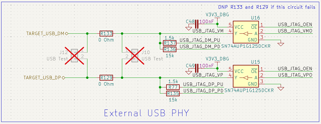

I'm designing a board that has USB, and I'd like to still be able to debug it. Accordingly, I've built a small test PCB that breaks out both the int and ext pins to a USB-C connector.
1. At boot, I get SERIAL_JTAG on INT USB
2. If I try the tinyusb console program, I get WARP on INT USB
3. If I call `usb_phy_ll_int_jtag_enable(&USB_SERIAL_JTAG);` then I get SERIAL_TAG back on INT USB even without deinitializing tinyusb
4. I get no useful output on EXT USB regardless of what I try.
When I say "no useful output" I mean I can see my host PC attempting to enumerate, but it gives up. I see traffic flowing -- both DP and DM -- but the ESP32-S3 does not do anything with the signals. The waveforms are well-shaped and do not appear to be suffering from any sort of contention. They are 3.3V, as is expected.
I would expect that I would see the MTDO/JTAG/GPIO40/OEN go high and some interesting data to appear on MTCK/JTAG/GPIO39/VPO and GPIO38/VMO, but those pins are absolutely still. It's as if they're not muxed for USB PHY support.
My PCB has D+ go to MTMS, and D- go to MTDI. Then pins MTCK and GPIO38 go through a small buffer (SN74AUP1G125DCKR) that outputs on negative edge.
Since I don't see GPIO38, MTCK, or MTDO toggling I can only assume that the block isn't receiving the signals.

One slightly concerning thing I'm starting to realize now that I have this board fabricated and I'm finding it doesn't work -- the `RCV` pin appears to be undocumented.
The reference manual on page 756 shows five pins are required: VP, VM, OEN, VPO, and VMO, but I see references in the code to a signal labeled "RCV". Furthermore, it appears to be on pin 21.

After shorting VP to GPIO21 I'm starting to get somewhere. So it definitely seems like it's missing something in the documentation. I'm going to rework a second board and see if I can get something updated.
Is the RCV signal documented anywhere, or will it be?

I just used a pair of buffers, but you might be able to do it with just a resistor. The part number is SN74AUP1G125DCKR. I also put down way too many resistors in case things went wrong. It seems to work well!

FWIW the part we used at Espressif to test this while it was in development is the SP5301. Not sure if that's still in production, though, although it's not hard to still get.
