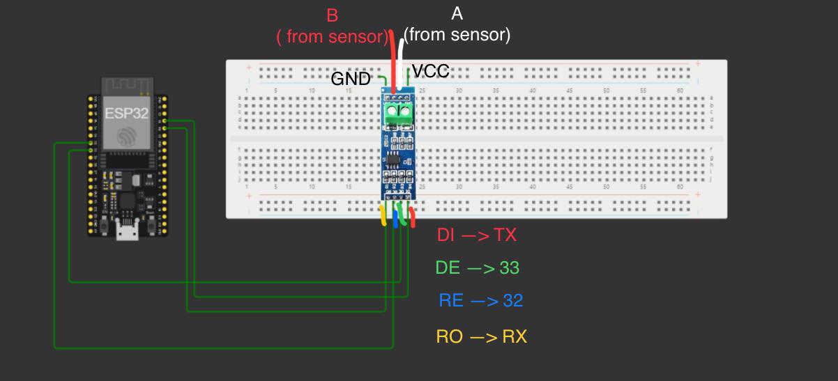

Postby yasmineK » Thu Nov 09, 2023 6:30 pm
I want to work with a sensor that uses Modbus as a communication protocol, to be able to use ESP32, I am using a TTL MAX485 converter.
Unfortunately the sensor is not responsing, sometimes it responds with the same request I send, sometimes it displaying nothing in the serial monitor.
Please can anyone help ?

Postby ESP_alisitsyn » Mon Nov 13, 2023 1:53 pm
Do you have the name of sensor and the Modbus protocol mapping table or the manual for this sensor?
If not, it will be very difficult to get the information. Please provide more information and I will try to help you to configure the device with esp-modbus. Also please describe you interface connection. Thanks.

Postby yasmineK » Mon Nov 13, 2023 3:15 pm
Thanks for your response,
Here is the datasheet of the sensor: https://files.seeedstudio.com/wiki/Diss ... Sensor.pdf
Here is a simulation of the circuit connection;
I am using a TTL converter MAX 485, noting that the converter needs 5V and the sensor needs 12V, I used two Buck-Boost converters to make sure they get the needed voltage.
Thanks again

Postby yasmineK » Mon Nov 13, 2023 3:28 pm
Here is the circuit of the esp32 and the TTL converter MAX485
Noting that the converter needs 5V and the sensor 12V, I used Buck-Boost Converters to make sure they get the needed voltage.
Thanks again

Postby ESP_alisitsyn » Thu Nov 23, 2023 10:02 am
Hello yasmineK,
Thank you for the information. You can use the modbus master example here: https://github.com/espressif/esp-idf/tr ... /mb_master to communicate with your device using RTU mode.
https://docs.espressif.com/projects/esp ... t-started/
https://docs.espressif.com/projects/esp ... odbus.html
You can use more simple code for the example like below: (you can simply change the source of `master.c` original example as below)

Please connect your adapter as below (recommended but you can change it to your pins):
#define MB_UART_RXD_PIN 22 // Connect to RO pin on your RS485 adapter
#define MB_UART_TXD_PIN 23 // DI pin on RS485 adapter
#define MB_UART_RTS_PIN 18 // DE-RE pins connected together
You can connect the VCC pin of your adapter to +5V (or 3.3V depends on adapter IC) pin on the ESP32 board. A-B pins of adapter connected to the A-B pins of your sensor. It is better to use the adapter with max483 IC with 3.3V output but for investigation purpose the 5V max or AD485 IC can also work normally with ESP32.
In this example you should get the measurements from your device.
See the communication log and post it here.
Thanks.

Hello yasmineK,
