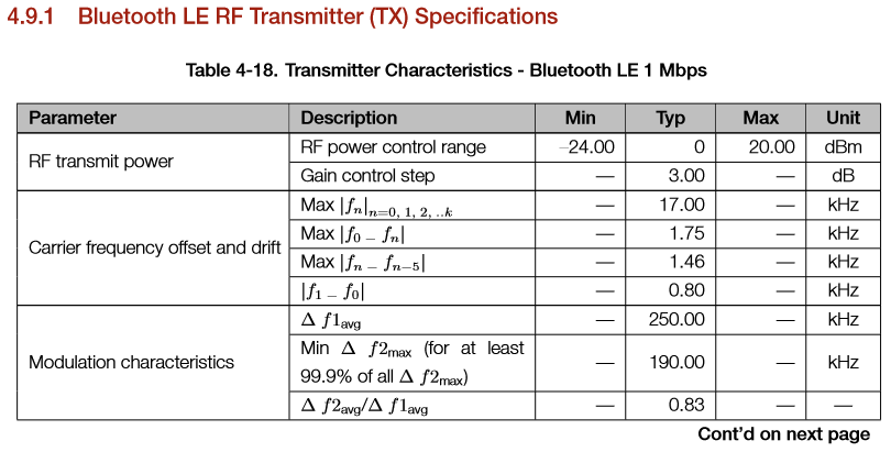

Hello. I'm in the process of submitting a product for an RF test that used ESP32-C3-MINI-1U for regulatory approval. I only use BLE communication without Wi-Fi.
There is a self-declare field that asks for the RF nominal power and RF burst power in "... dBm ± ... dB" format.
Per the datasheet, which value should I put there?
Thank you.
