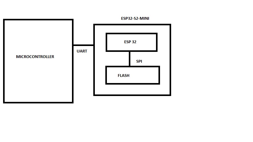

I think you're not understanding how ESP32 chips work. ESP chips or modules don't have their own flash on-silicon; they must be paired with some kind of SPI flash that contains the program they run. That flash can be either in the chip package or in the module or added externally. That is what 'SPI' refers to. This SPI flash gets programmed by the ESP32 by putting the ESP32 into download mode and sending it commands via the UART; the UART connection is what the library I linked to implements. As the UART commands describe what the ESP32 needs to do to the SPI flash, you will see 'SPI' in the source code, but that does not refer to the connection between your microcontroller and the ESP32; that still is UART.

Postby dhineshdhamodar. » Wed Nov 22, 2023 9:24 am
Hope that clears things up.
Thanks for sharing the information,
Just I want a confirmation, against on your shared overview information? please refer the below attachment for my understanding!
And could you please share me the UART protocol document for BOOTLOADER RE-FLASHING.

It would be easier for us to help you if you explained what you would like to achieve, instead of asking for pieces of technical information. Your diagram above is correct. Here is the documentation on the serial bootloader from esptool.
https://docs.espressif.com/projects/esp ... tocol.html

Note that there are two bootloaders: the first stage lives in ROM and cannot be flashed ever, the 2nd stage lives in the SPI flash and you generally flash that automatically along with your application.
