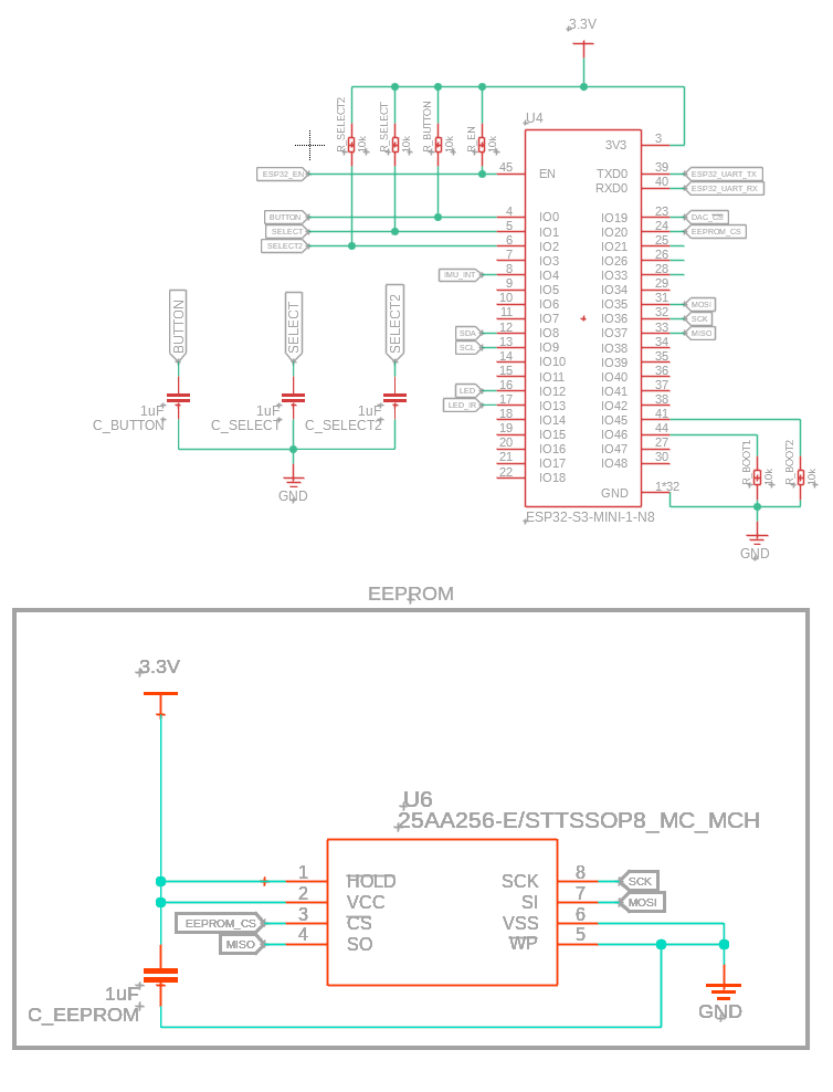

Hi, I have a custom PCB with the S3 Mini and an EEPROM chip (very basic schematics for your reference). The code (modified from a git repo I found, also attached) worked with a Wrover Dev kit + breadboard, but for the PCB, EEPROM read operations always give "0" even after writing (see the two sections in loop()). I am wondering if I have misinterpreted how GPIO can be mapped to SPI bus.
I am using MATLAB to send serial data for writing to EEPROM. MATLAB confirms the serial response, but it seems that the writing operation is not working.
Thanks!

lbernstone
- Posts: 1131
Re: ESP32 S3 MINI SPI Pins
If you are able to send a command to the eeprom, and get a response, then it seems like your electrical connections are good.
Turn on verbose debugging and make sure you see a response from the eeprom device.
Does it work if you write to flash/nvs instead of the eeprom?
The only pin mapping issues that I can see is that you are using the USB pins for the SPI. However, as long as you don't enable usb at all, that should only have an effect at boot.

James_7122

Thanks so much for the reply. Being new to ESP32 programming in Arduino, I have tried very hard to enable verbose logging, referencing this link (https://esp32.com/viewtopic.php?t=5730) but I have had no luck (INO below). Am I missing something?
I tried adding the following to my SPI setup:
I am puzzled by the fact that none of these functions (SPI-begin, SPI-transfer, SPI->set*) returns any kind of error code. SPI->transfer returns 0 no matter what pins I map in the setup, so I don't think the communication is actually happening.
The following code prints nothing:
[/code]
mySPI->begin(36, 37, 35, SS);
SPISettings s;
mySPI->beginTransaction(s);The following code prints nothing:

lbernstone
- Posts: 1131
https://docs.platformio.org/en/latest/p ... ebug-level
The SPI functions are void (Arduino spec?), but the underlying function calls should give you errors in verbose logging.

EDIT: I managed to get verbose debugging, and the logs in setup() above actually go to the serial monitor now. SPI->transfer definitely doesn't create any logs that I can see

Now it's getting very strange. I wanted to test the pins themselves, so I used the following "blinky" code and tested with a multimeter. Pin 36 fluctuates between 3.3V and 2.4V, and pin 37 fluctuates between 0.5V and 0.8V, and pin 35 correctly fluctuates between 3.3 and 0. Why could this be?

lbernstone
- Posts: 1131
This sounds like normal operation for an SPI bus. If there is a lot of variability of the voltage level, that could imply you don't have enough capacitance and filtering on the devices. Look at the datasheets and design guides for the eeprom and esp32 to get appropriate values for capacitance, and you should almost always have a 100nF filter on the input to digital devices.
The correct tool for troubleshooting this is a logic analyzer, where you can see the conversation happening b/w the devices. Again, I ask, does this work if you write to flash. Why are you using an eeprom when you have megabytes on board the esp32.
