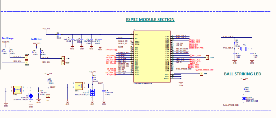

Hi
Thank you very much for replying. I am sure my DC-DC converter is capable enough I have used part#TPS631000DRLR from Texas Instrument and measured stable 3.3V
Also please see below snaps of my design.
Do you think increasing R/C network time delay of CHIP_PU(EN Pin) will help, with the value like 4.7uF or 10uF.
Is my above GPIO's mentioned in initial thread is properly latched with either high/low, any changes expected over there

Re: ESP32-S3 WROOM-1U Brown-out reset problem and Flashing fails
Did you also measure that on the castellated pads of the module itself? Also with a scope, so you can see even very short power dips?Thank you very much for replying. I am sure my DC-DC converter is capable enough I have used part#TPS631000DRLR from Texas Instrument and measured stable 3.3V
That design doesn't tell me much; you didn't even include the power supply. Modifying the EN RC network won't help; if that was the issue you wouldn't get *continuous* brownouts. The GPIOs also don't cause the brownouts, so I suggest you keep those out of your mind for now.Also please see below snaps of my design.
