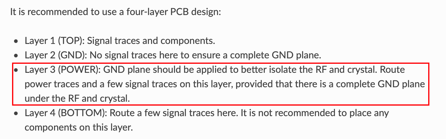

thank you. The Trace to the Antenna should be 50Ω single ended impedance.
Matching circuit is intended for matching LNA_IN pins output impedance to the trace and later to the antenna.
However Hardware design guide and Datasheet do not mention the ouput impedance of LNA_IN pin, so this is what i am looking for.
In addition I think there is an error in https://docs.espressif.com/projects/esp ... tub-layout. As stated the stub from first C should be connected to L3 (which is power according to stackup) and I do think this should be L2 which is supposed to be GND.
Is the output impedance the same as ESP32-C3? I found here https://esp32.com/viewtopic.php?t=21649 that it should be: (30 ~ 40) ±10 jΩ
Or is the package already matched internally to 50Ω?
