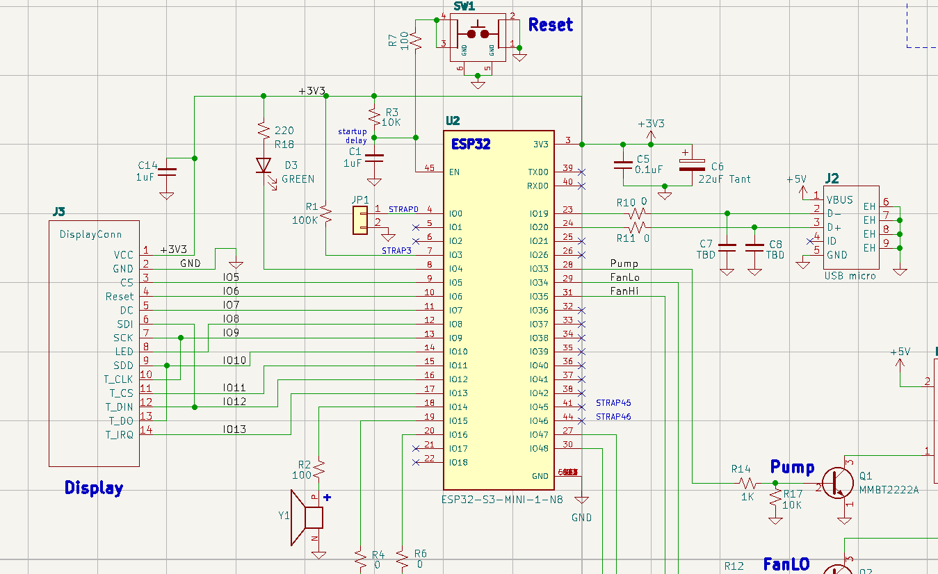

Using Arduino 1.8.16, I'm trying to program this ESP32S3-Mini-1:
Screenshot 2024-03-25 131959.png (40.73 KiB) Viewed 3030 times

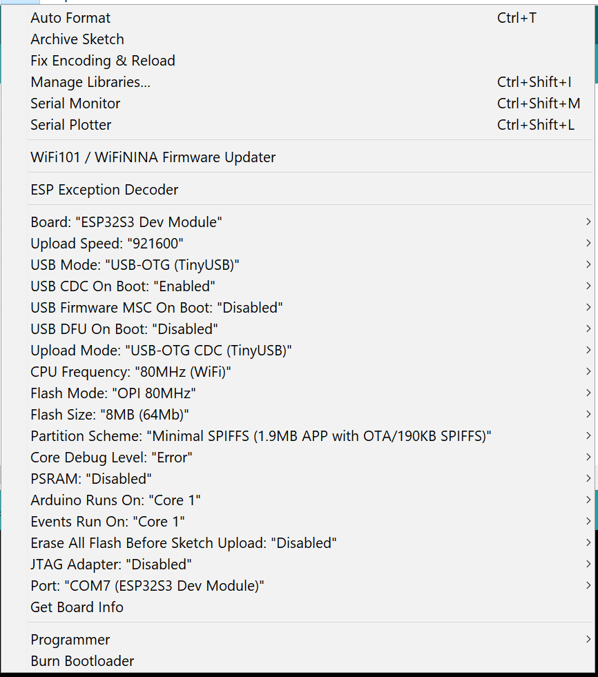

My tools setup is:
Screenshot 2024-03-25 131746.png (73.95 KiB) Viewed 3030 times
***NOTE: I've also tried this with Flash mode set to QIO 80MHz & QIO 120 MHz

Pin 1 is strapped low for programming, and the board seems to program OK, then I remove the strap and reboot. But I am unable to achieve serial or audio output. I've tried many (perhaps all) combinations of tool settings to no avail.
Any ideas as to what I might be doing wrong or might try would be greatly appreciated.

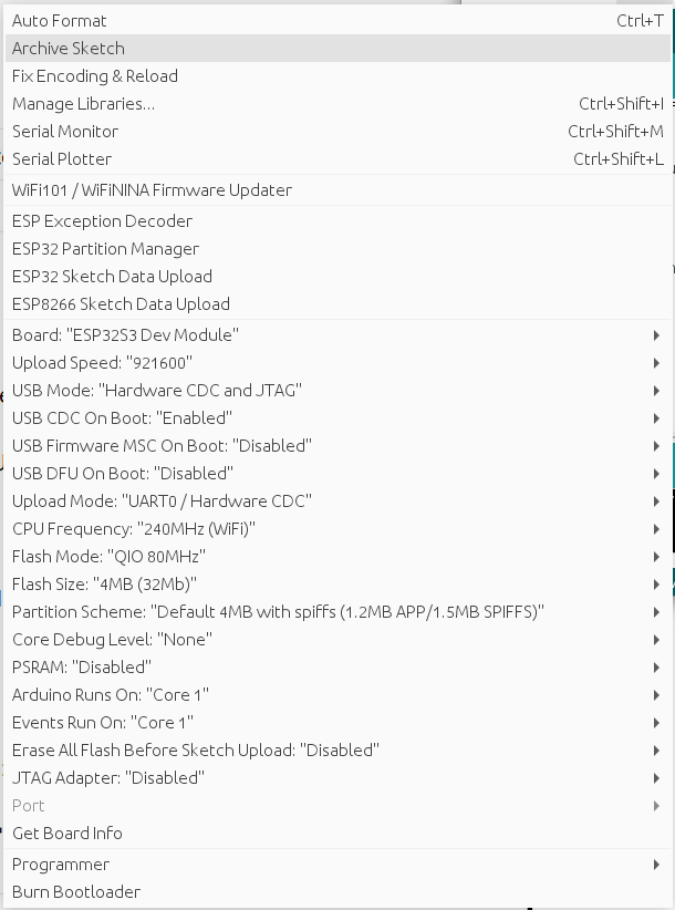

If you are not intending to make a USB device out of the esp32, then you want hardware CDC. You also will want the ID pin on your USB port tied to ground with 5K1 (this sets USB-OTG). Try this:
Screenshot from 2024-03-25 11-01-00.png (74.07 KiB) Viewed 3010 times

lbernstone, many thanks for your suggestions.
I tried using your tool settings: the board programmed and I began seeing the expected serial output!
I then increased the Flash Size to 8MB and the partition scheme to "Minimal SPIFFS (1.9MB APP with OTA/190KB SPIFFS)" (I believe I'm using ESP32-S3-Mini-1-N8, though it's hard to confirm from the markings). Now it seemed to program but failed to run. I then returned the Tools settings to your suggested settings and could not get serial output again, even after rebooting my computer.
I then added the 5.1K resistor from the USB ID pin to ground. It made no difference, I am back to (apparently) able to program the board but unable to get it running.
My chip is ESP32-S3 (revision v0.2); could this early revision be the problem?

Just to check, C7/C8 are not populated on your board, right? (They shouldn't be, a capacitor there will interfere with USB)

Thanks for asking, ESP_Sprite. Yes, C7 & C8 are not populated.
