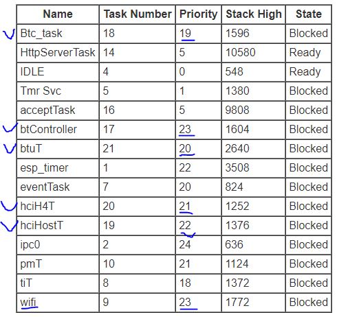

Postby chegewara » Mon Dec 18, 2017 7:51 am
System tasks priority list (all but acceptTask and HttpServerTask are system tasks):
