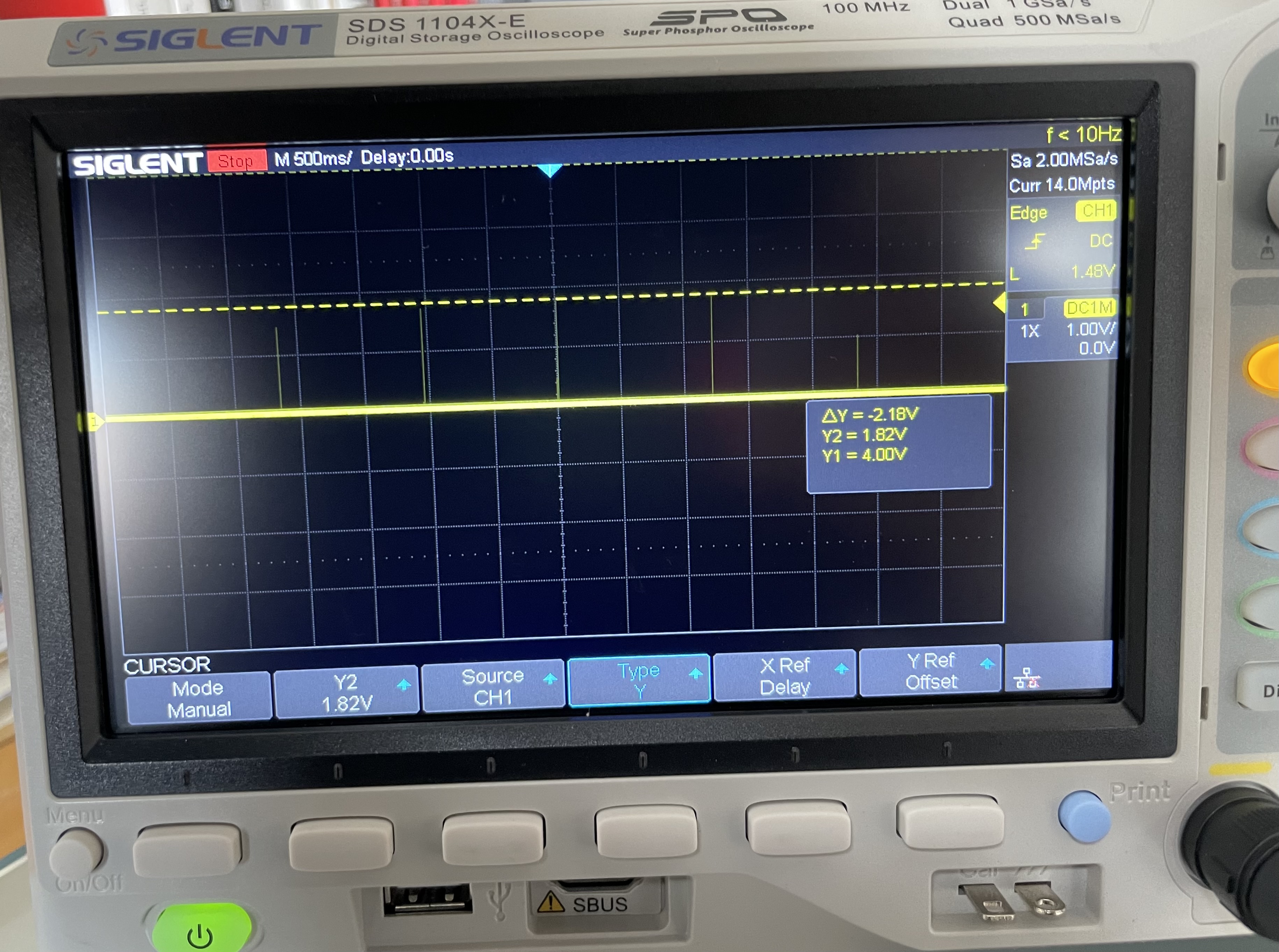

I did some measurements as you can see in the attached picture. You can see, that GPIO11 is somehow going high directly at startup. I have the same PCB (same batch from manufacturer) without these spikes.
Can anyone explain this? Since we are about to start series production, I need to know what is going on and how to fix it. It happens on 3 of 18 PCBs.
