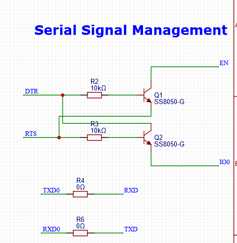

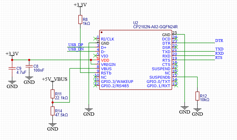

I have a few years of coding arduino, esp8266, esp32 as a hobbyist and decided to build my first custom board based on the esp32-wroom-32e, I thought the best way to make it accessible was through a cp2102n-a02 for the usb to serial conversion. There begins the problems.
The boards arrived, but I cannot get any serial connection to it. After some time I realised I screwed up- I did not flip one of the transistors that connects the DTR/RTS signals to the IO0 and EN pins of the esp32. Ooops.
I attached pictures from my schematic of the wiring to the cp2102n, the logic where my mistake was made and the reset button which I included to show I did include a capacitor and pull up resistor to IO0.
Is there anyway to save these boards? When I plug them into the PC they do not even register on "dmesg" or "lsusb" as if nothing is there but the power LED is lit and power is reaching the whole board. Thanks in advance!

Re: Made a mistake with my CP2102 DTR/RTS wiring. Anyway to save it?
Well, the obvious way to fix it would be to rework the board: desolder the transistor, and assuming it's a SOT-23 one, bend all the pins upwards and solder it upside down and rotated by 1/3 turn on the board so the pinout matches the intended pinout.
The thing is that this is not the only mistake on the board: this would stop you from being able to program it, but it would still show up as a serial USB device. I can't immediately see any issues with how your CP2102 is connected, so I think it's either a physical issue or an issue somewhere else in your schematics.

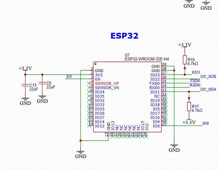

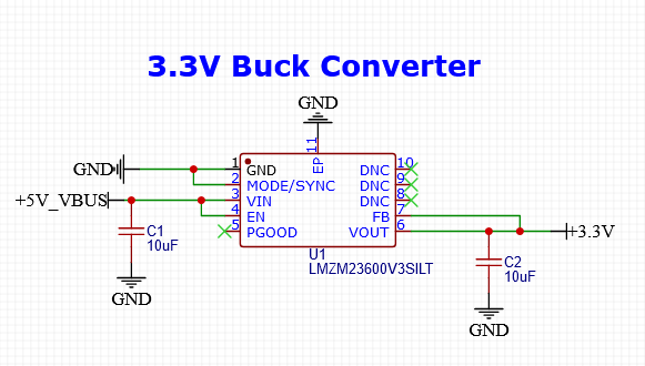

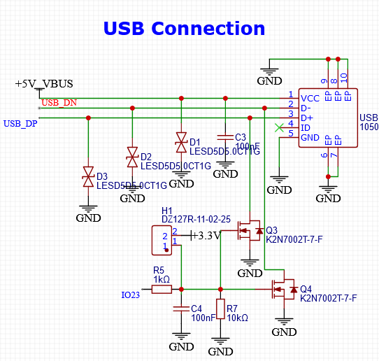

Thank you for the reply! That makes sense because since posting I desoldered Q2 and "flipped" the device by soldering on wires to the correct direction but that did not help. This was meant to be a first test project with just a few sensors to create a minturised environmental monitoring system, I copied this tutorial for the vast majority of the board: https://oshwlab.com/robertferanec/esp32-tutorial
I attached the usb, power (which defintitely works) and esp32 board any help with where my mistake was I would be very grateful as I am quite lost with my mistake! Otherwise today I will be soldering jumpers and using a usb based converter to try to connect to the esp32 directly and try that.
Apparently, the VBUS pin of the CP2102 "should be connected to the VBUS signal of a USB network. A 5V signal on this pin indicates a USB network connection."
Also, where does the 3V3 power come from when USB is connected?
I think you should connect VREGIN to USB 5V to power the 2102 from USB, and you may have to add a capacitor between VREGIN and VDD to stabilize the regulator.
The regulator can also supply 100mA max on VDD, so keep that in mind if you're using it to power other circuitry.
I don't trust the circuitry around Q3/Q4. I'd remove those, see if that clears things up. (I know they're a workaround for a CP2102 issue, but I have seen a gazillion boards without the workaround and they work just fine, so I don't expect removing Q3/Q4 leading to issues.) If anything, I think the workaround is implemented wrong by the guy you cribbed the schematic from: the errata says to route the gate to a GPIO of the *cp2102*, not the ESP32, and then use some software to configure the CP2102 to do the right thing.
Hi ESP_Sprite thank you for the input it helps a lot. It takes about 12 hours for my reply to be posted I find so I have tried a few things and made some progress! Still not quite there but I have definitely narrowed it down to a problem with how I setup the CP2012N:
1. On one of the boards I removed the CP2102N completely and I soldered jumper cables directly to RXD and TXD, before connecting it to an external USB to UART chip. By pressing "boot" and "reset" together voila! I have connection to the esp32 and I could upload some sample code!! Ugly yet progress because once the code is on I can just desolder the wires. Only 24 more to go!
2. I desoldered Q3 and Q4 as you mentioned. I now can connect to the CP2102N with my PC (it shows up with lsusb and dmesg) so you are completely right it was not implemented correctly and in fact is not necessary. BUT I cannot find the esp32. So now I have connection to the CP2102N but there is something wrong with the connection to the esp32.
IT LIIIIVES!!! Problem is solved now.
Turns out there was a second problem that meant that communication was not working. My computer. For some reason the front usb ports on my ancient work PC are not functioning correctly. So after I de soldered the "errata solution" as mentioned by ESP_Sprite (thank you again!!) I could connect to the cp2012n but not the esp32. Drove me crazy until I went and plugged it into a different computer. Hey presto connection is valid and I can upload code (holding down boot and pressing reset).
Thanks for all the help!!
