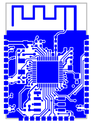

Have a few questions arround technicals outside your Developer Brief:
a) Have read that Core is Tensilica Diamond 108. Right ?
b) We have 128 KB Instruction RAM ?
c) We have 128 KB Data RAM0 and 128 KB Data RAM1 ?
d) We have full eMMC Support ?
e) Chip Size Pack is QFN ?
f) More accurate : QFN 48 ?
g) More detail accurate : 7 mm x 7 mm ?
h) Pico More detail accurate : Is this the new ESP32 alias ESP8632
http://esp32.de/IMG_1550.JPG
i) Chip Layer is 50 ?
j) Is there just in Time Docu about Pin List? ( eagle lib, cad )
k) Is there just in Time Docu about Pin Function? ( HDK recommendation )
Would fine for all answeres ;-)

Re: What Core does ESP32 is and which Chip Pack size we must solder and other..?
Postby johnlee » Sun Nov 15, 2015 7:49 am
Yes, it's a Tensilica L108 Core.
The memory map will be release soon.
Yes, we have full support for eMMC.
6mm x 6mm QFN 48 pin.
The names are still being debated internally.
Number of layers in the chip layer is about 40, if it's the process steps that you are counting. We are considered frugal in this respect. :_)
Hardware docs for the modules will be available next week.
Same for pin functions.
