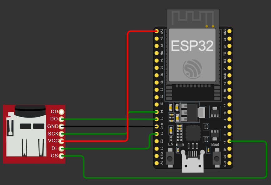

Hello, I have a problem connecting a microsd to an esp32.
I have these declaration at the beginning of my code
#include <stdio.h>
#include <stdlib.h>
#include <string.h>
#include "freertos/task.h"
#include "esp_log.h"
#include "sdmmc_cmd.h"
#include "esp_vfs_fat.h"
#include "driver/sdmmc_host.h"
#include "driver/sdspi_host.h"
#include "driver/sdmmc_types.h"
#include "esp_err.h"
#include "hal/spi_types.h"
#include "driver/spi_common.h"
#include "driver/spi_master.h"
#include "driver/gpio.h"
#define PIN_MISO 12
#define PIN_MOSI 13
#define PIN_SCK 14
#define PIN_CS 15
#define MAX_CHAR_SIZE 100
#define TAG "SD_CARD"
#define TARJETA_SD "/sdcard"
esp_err_t initSD();
and sd funtion
esp_err_t initSD(){
  sdmmc_card_t* card;
   esp_err_t ret;
  esp_vfs_fat_sdmmc_mount_config_t mount_conf = {
    .format_if_mount_failed = false,
    .max_files = 5,
    .allocation_unit_size =  16 * 1024
 sdmmc_host_t host = SDSPI_HOST_DEFAULT();
    spi_bus_config_t buscfg = {
        .miso_io_num = PIN_MISO,
        .mosi_io_num = PIN_MOSI,
        .sclk_io_num = PIN_SCK,
        .quadwp_io_num = -1,
        .quadhd_io_num = -1,
        .max_transfer_sz = 4096
     ret = spi_bus_initialize(host.slot, &buscfg, SDSPI_DEFAULT_DMA);
    if (ret != ESP_OK) {
        printf("\nERROR SPI BUS\n");
        return ret;
    sdspi_device_config_t slot_config = {
        .host_id = host.slot,
        .gpio_cs = PIN_CS,
        .gpio_cd = -1,
        .gpio_wp = -1,
        .gpio_int = -1,
  ret = esp_vfs_fat_sdspi_mount("/sdcard", &host, &slot_config, &mount_conf, &card);
  if(ret != ESP_OK){
    if(ret == ESP_FAIL){
      printf("\nESP_FAIL ERROR: 0x%x\n", ret);
    else
        printf("\nERROR ret: 0x%x\n", ret);
    return ESP_FAIL;
sdmmc_card_print_info(stdout, card);
  return ESP_OK;
I am using the wokwi simulator, I don't know if it is a problem with the simulator or something is wrong with me, I get these errors:
configsip: 0, SPIWP:0xee
mode:DIO, clock div:2
load:0x3fff0030,len:1156
load:0x40078000,len:11456
ho 0 tail 12 room 4
load:0x40080400,len:2972
entry 0x400805dc
[0;31mE (876) sdmmc_sd: sdmmc_init_sd_if_cond: send_if_cond (1) returned 0x108[0m
[0;31mE (876) vfs_fat_sdmmc: sdmmc_card_init failed (0x108).[0m
ERROR ret: 0x108
 >Failed to boot sd<
Failed to open file for writing
Error file create
Failed to open file for reading
Error read
I know I need to add to SD library in Wokwi Library Manager, my project already has it.
I used to have a project similar to this that did work but I don't know if it's a problem now because of wokwi or if I need to change something.
In espressif the error 0x108 is: ESP_ERR_INVALID_RESPONSE (0x108): Received response was invalid

I don't see any obvious errors in your code, therefore probably a Wokvi issue.
If you have been using Wokvi for a while, can you give us comparison of Wokvi and real HW for development?
