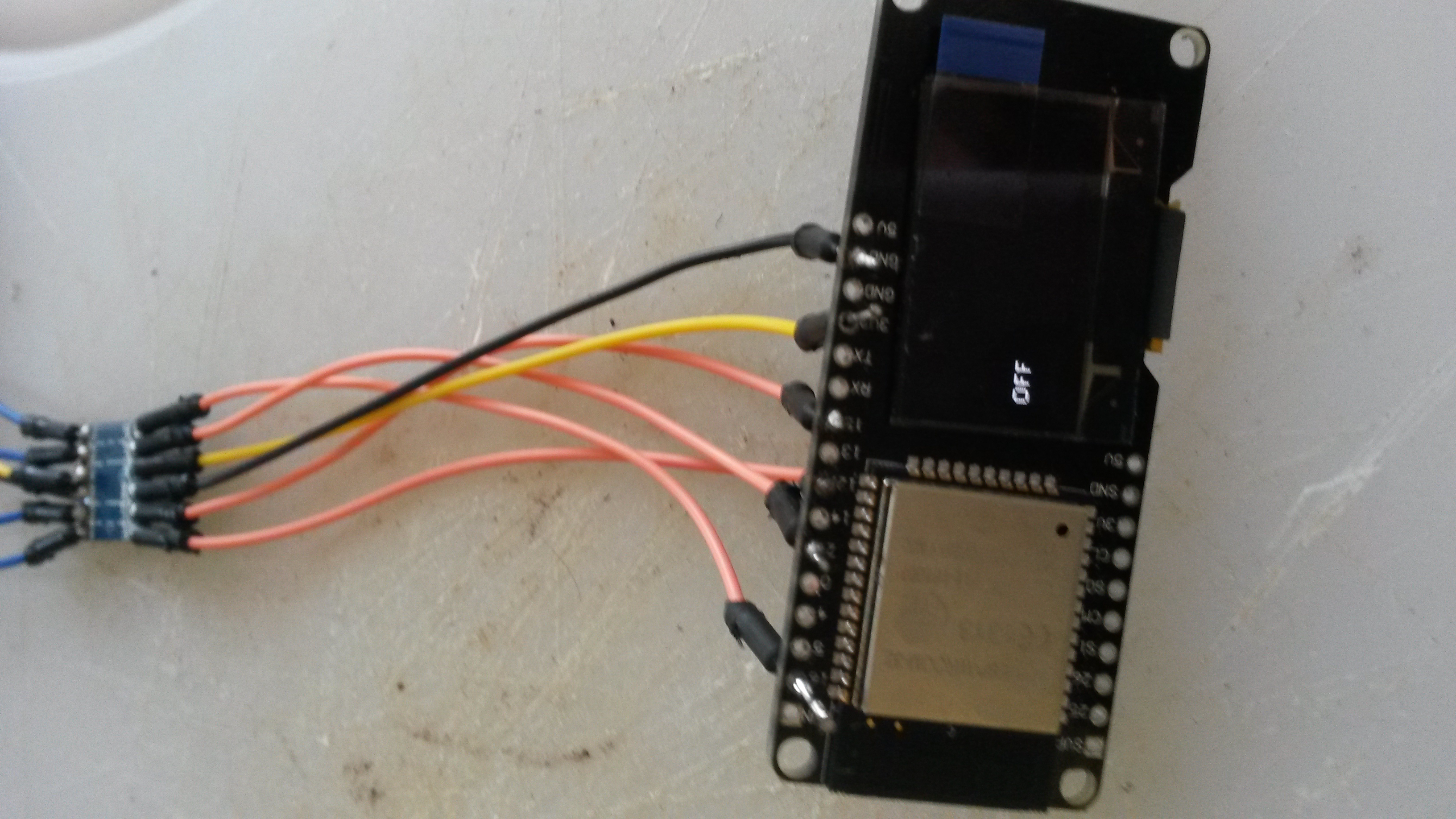

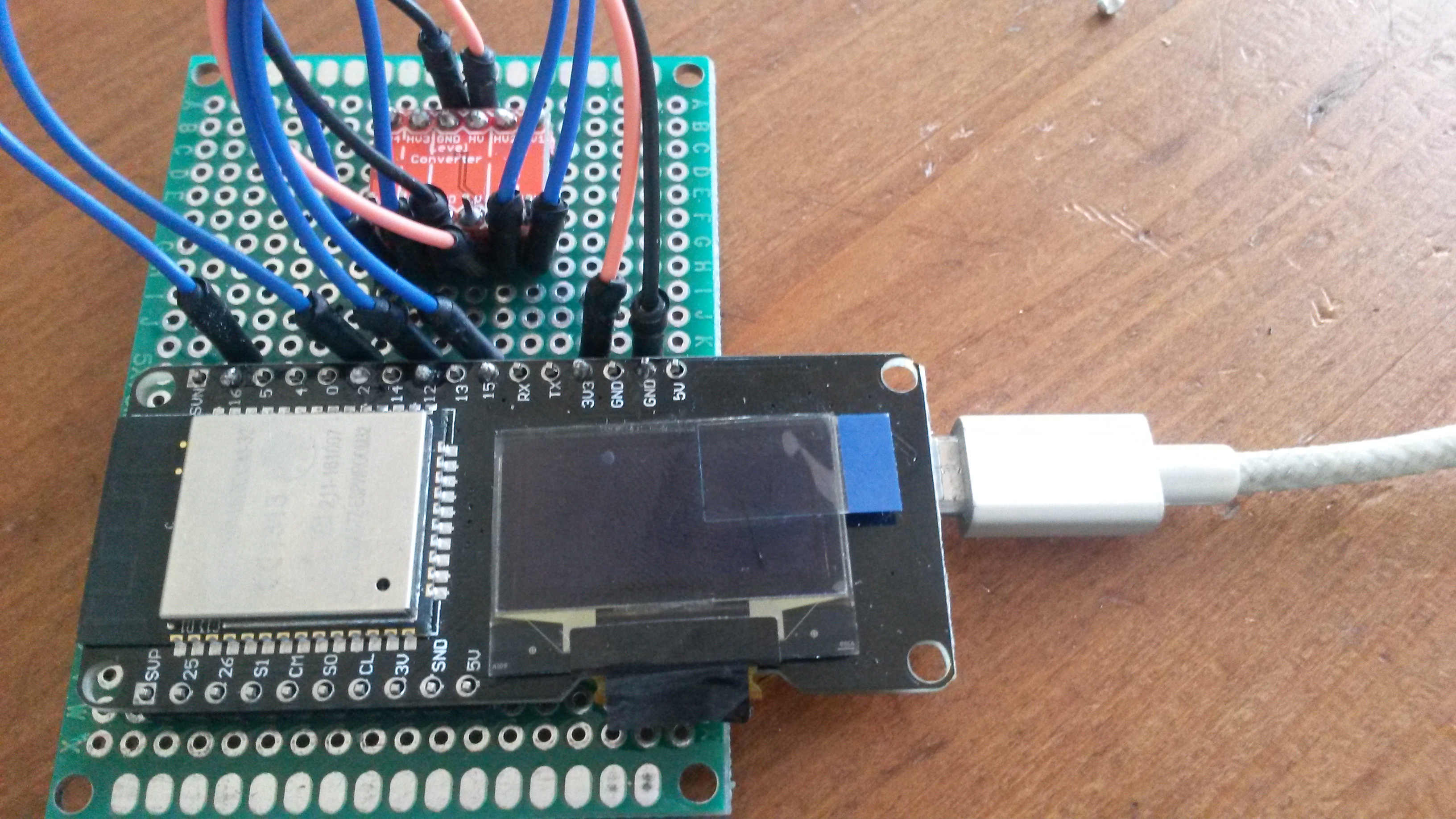

Re: MD5 of file doas not match data in flash ( fatal error )
Thanks a lot for your answer .
Yes the boards were working when pluged it for the first time ( there is always a little demo in the screen ) .
Then i was able to upload the code .
Here is the exact board that i have : http://www.instructables.com/id/ESP32-W ... ting-Star/
And according to the picture, GPIOs that are used by the internal SPI flash where free ( nothing was pluged on GPIO 6,7,8,11).
i don't see GPIO 9 and 10 as the picture is showing.
But i can't upload anything now. I just have the code of my first upload on it, but i can't do anything else .
The GPIO that are used are : 16 , 2 , 13,12,15 ( all are in the right side of the board ) and Yes they are connected during the process of upload.
i attached 2 pictures for showing you the exact schema.
I used 2 different boards, and when i try to upload something on these boards i have 2 different fatal error.
For the first board ( first picture ) i have the MD5 fatal error that i send to you on my first message whenever i try to upload something. As you can see when i plug the board the program that is into it ( from the very first upload ) is not starting.
for the second board
i have another fatal error whenever i try to upload again :

But as you can see on the picture the program is starting ( you can see the "OFF" message which is from my code )
Is it a way to reinitialze everything ? it's important for me to understand what bad actions i did to not reproduce them.
if you have a tutorial or documents that shows how to reinitilize the board it would be nice
If you have an answer it's even better lol. i just hope that i didn't kill the boards.
Read esp32 datasheet strapping pins section. 15 and more importantly 2 and 12 are strapping pins.
