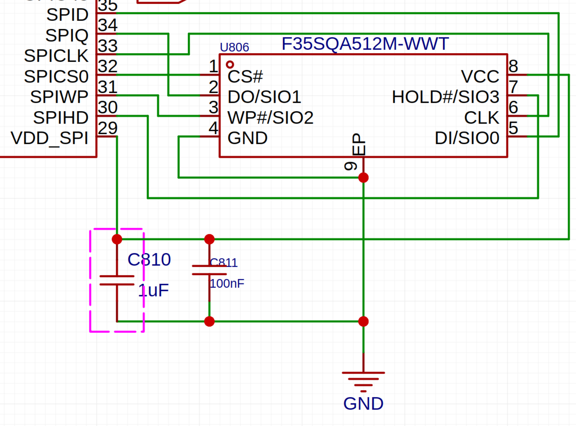

Hello, I made a PCB with ESP32-S3 and a 512Mb external SPI flash (F35SQA512M-WWT - 512Mb - up to 133Mhz)
I already did several other esp design with external flash but it seems I missed something on this one:
- I have GPIO 45 pulled down so the VDDSPI = 3.3V
- the SPI flash is connected to the ESP32-S3 like this:
Screenshot from 2024-07-08 17-04-28.png (406.5 KiB) Viewed 8660 times
- when i try to upload the stub in order to flash the bootloader, I have this (same error with any flash mode or freq)

0x3f3f3f seems a little bit redondant... I'm ready for an answer like "the flash is not compatible" but I really wonder why it would not be ?
Thank you for your time :)

It's NAND flash; the S3 cannot boot from that. You want NOR flash; chips like that tend to start with '25' rather than '35'.

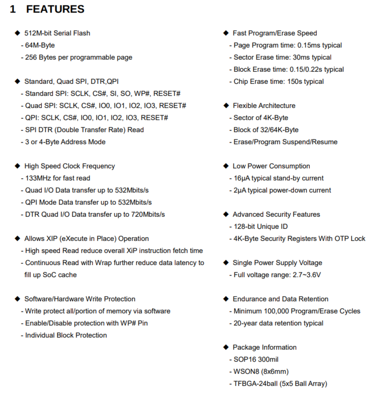

Is GD25B512MEYIGR fully supported ?
Is there a source code I can refer about fully supported chips ?

So I changed the chip with a GD25B512MEYIGR that is detected by the esp32s3:
esptool.py --port /dev/ttyACM0 flash_id
esptool.py v4.8.dev4
Serial port /dev/ttyACM0
Connecting...
Detecting chip type... ESP32-S3
Chip is ESP32-S3 (QFN56) (revision v0.2)
Features: WiFi, BLE
Crystal is 40MHz
MAC: 30:30:f9:2f:2e:08
Uploading stub...
Running stub...
Stub running...
Manufacturer: c8
Device: 471a
Detected flash size: 64MB
Flash type set in eFuse: quad (4 data lines)
Flash voltage set by a strapping pin to 3.3V
Hard resetting via RTS pin...
I can flash the chip, with simple projects like hello world.
