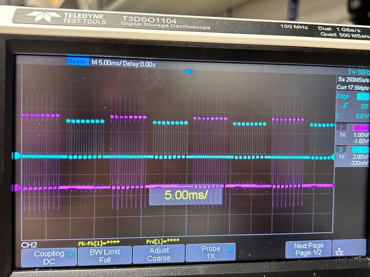

Hi! I'm using a esp32-WROVER-IE and Arduino IDE for programming. I'm trying to read from the Intan RHD Recording Headstages, which send data on both the rising end falling edge of the SCK. To read during the rising and falling edge, I'm trying to use both VSPI and HSPI, but delay one of the SCK by half a cycle, so that when one SCK is on the rising edge, the other is falling and vise versa to read all the data send by the RHD recording headstage.
When I try to measure both VSPI and HSPI SCK with an oscilloscope, I noticed that the SCK isn't always sending signals, rather it's alternating between flattening and sending SCK signals, and when one SPI is flattening, the other is sending the signals. (image attached below to show what I mean). Is that just how SCK work or is there a delay in the code that I didn't realize? is there a way to make both SCK send signals at the same time? (code attached below)
Also, I'm thinking to add a delay() between the spi.begin to do what I mentioned above. Is that possible? And is there potentially a better and more efficient solution?

If you have that option, you could consider switching to an ESP32-S3. The 'using both rising and falling edges' is called 'DDR' and the S3 supports that natively. (Although I'm not sure if the Arduino SPI SDK does; you may need to use the ESP-IDF SPI driver instead.)
Alternatively, if you still can change the hardware, you could add a simple D flipflop (e.g. a 74LVC1G74) to divide the SCLK by half.
