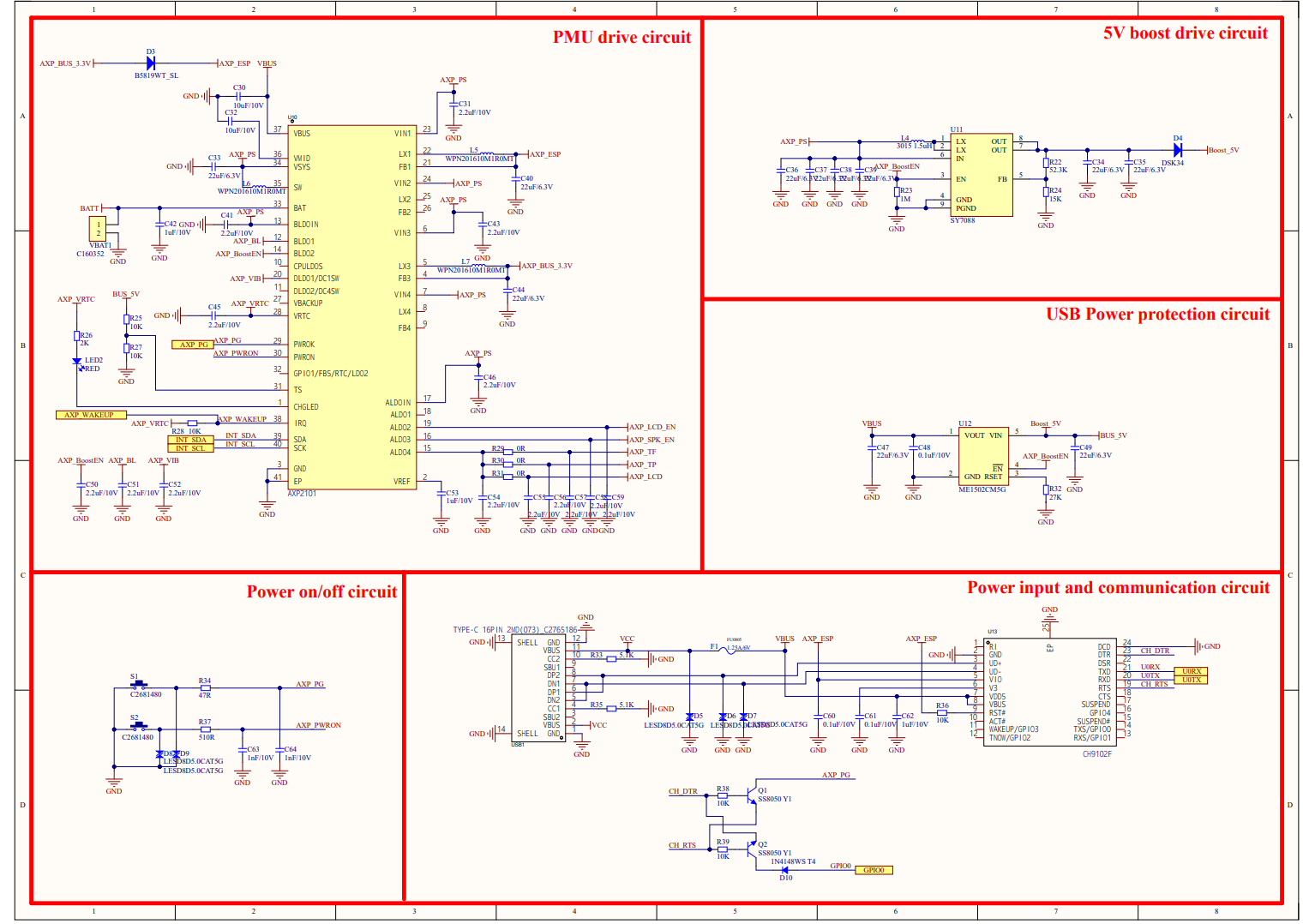

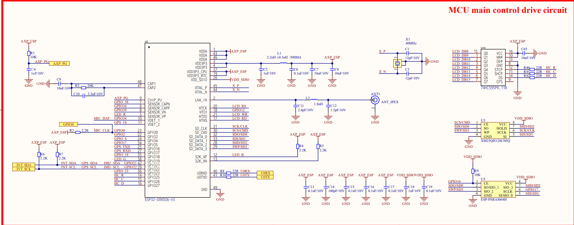

Schematics attached.
Thanks in advance for your help!
MCU Schematic
PMU Schematic

I don't see anything wrong with your schematic. You could try to remove D10 temporarily to see if the issue is in the auto-reset circuit or elsewhere.

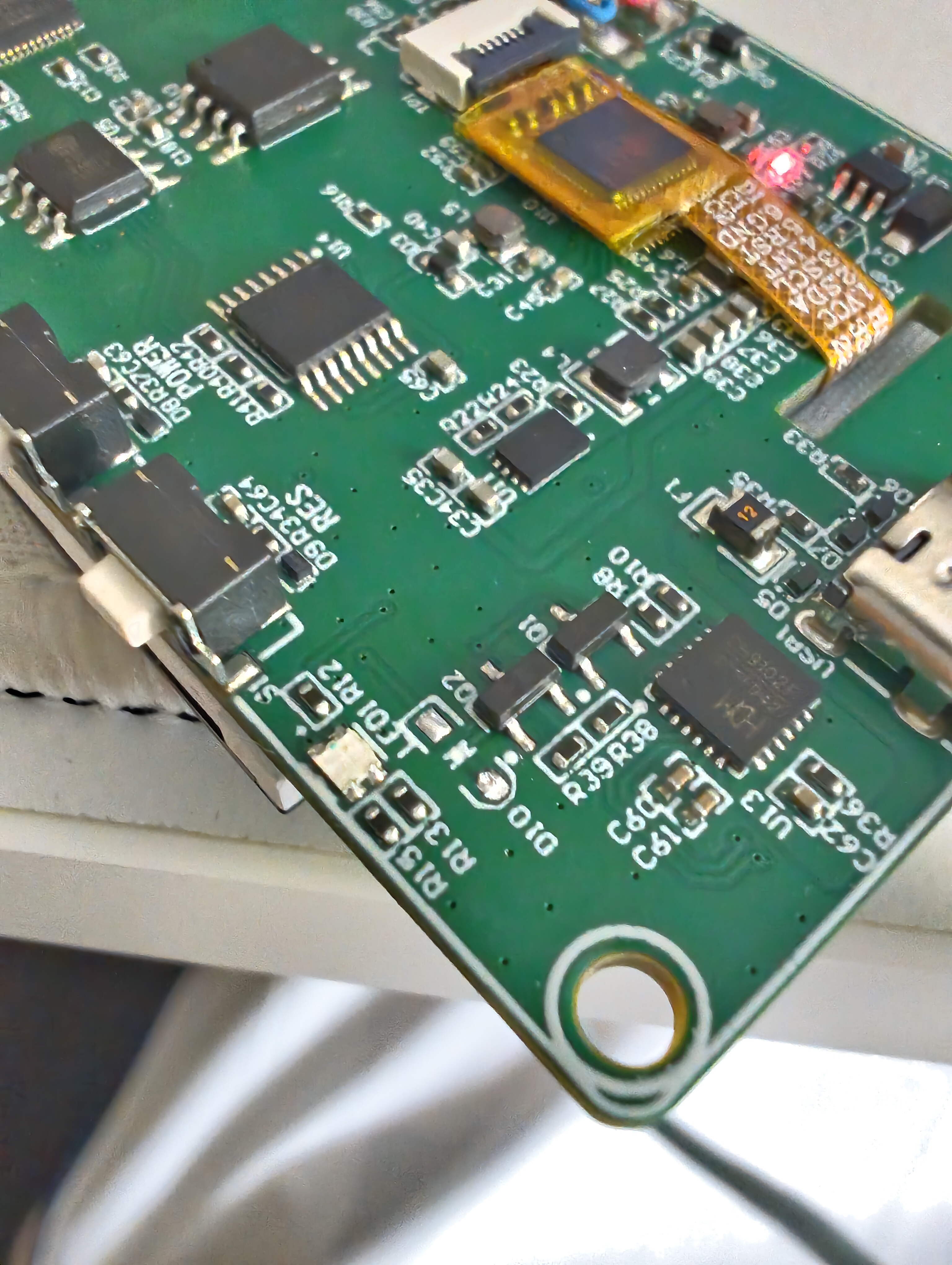

Hi there ESP_Sprite, thanks for the reply. I'm the other person of the project in terms of hardware and programming.
I tried the following:
- Desolder the D10 Diode to see if the issue was the autoreset or not, sadly it didn't work.
- I also tried to bridge the GPIO0 to the 3.3V bus to keep it high. No luck either, still in download mode.
We are gonna contact the company that did this but we are quite confused what can it be.

D10 Removed.

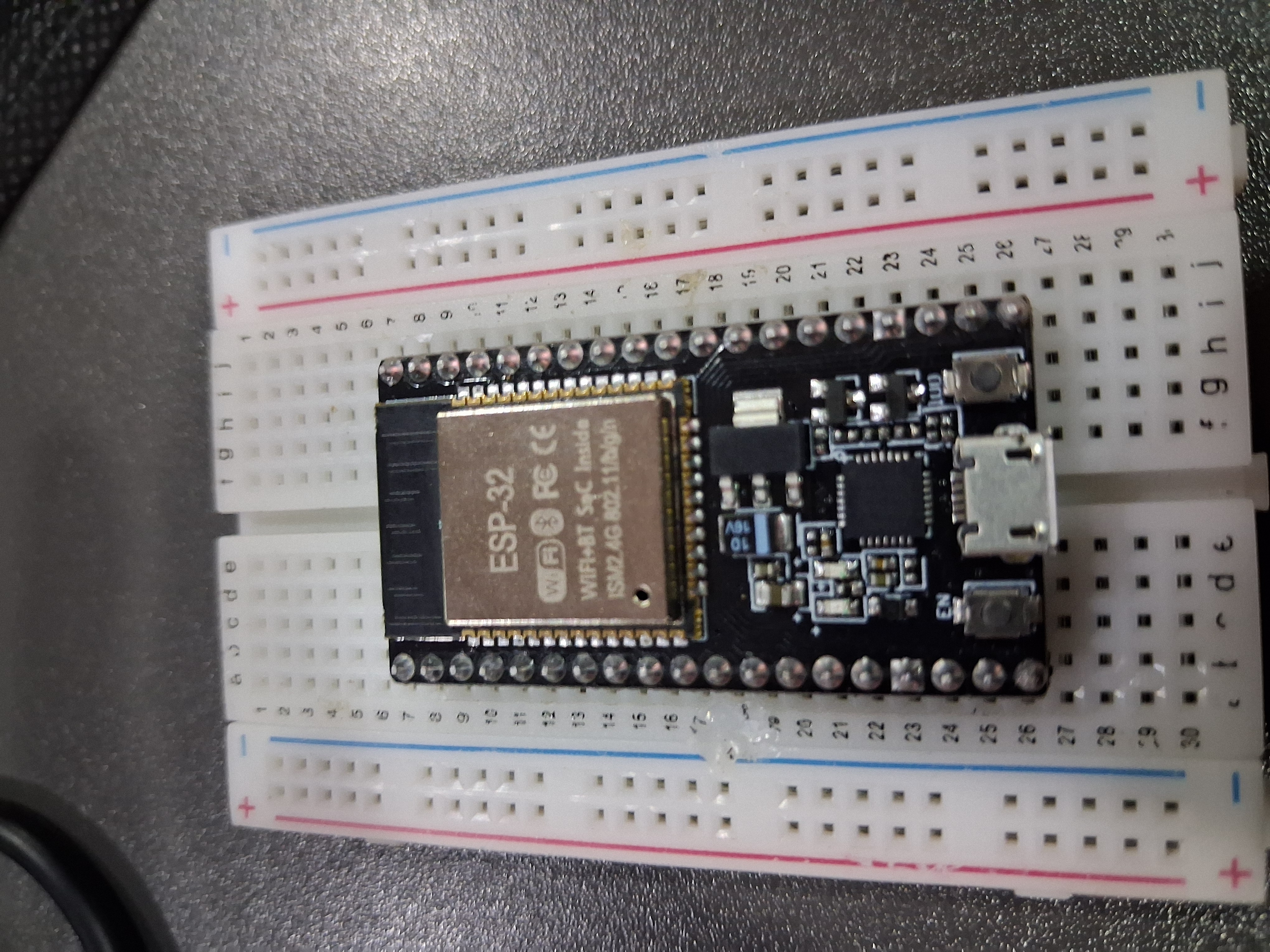

Were you able to resolve this issue? I am having this same issue. I am still working on my breadboard and I have stripped it of everything but the esp32. When I run the serial monitor it keeps saying waiting for download. I have tried resetting and connecting GPIO0 to the blue rail but it doesn't fix
