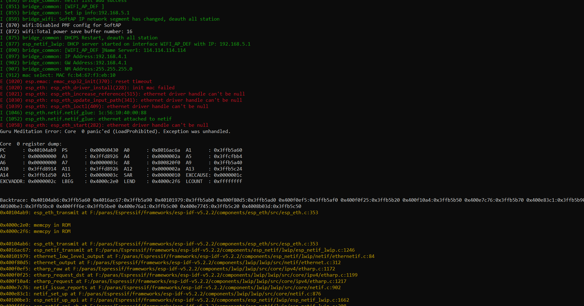

Error Messages with Log:
E (597) esp_core_dump_flash: No core dump partition found!
E (603) esp_core_dump_flash: No core dump partition found!
E (1018) esp.emac: emac_esp32_init(370): reset timeout
E (1018) esp_eth: esp_eth_driver_install(228): init mac failed
E (1019) esp_eth: esp_eth_increase_reference(515): ethernet driver handle can't be null
E (1028) esp_eth: esp_eth_update_input_path(341): ethernet driver handle can't be null
E (1037) esp_eth: esp_eth_ioctl(409): ethernet driver handle can't be null
E (1056) esp_eth: esp_eth_start(282): ethernet driver handle can't be null
Guru Meditation Error: Core 0 panic'ed (LoadProhibited). Exception was unhandled.
ELF file SHA256: bc96f1bd8
E (1158) esp_core_dump_flash: Core dump flash config is corrupted! CRC=0x7bd5c66f instead of 0x0
E (1167) esp_core_dump_elf: Elf write init failed!
E (1173) esp_core_dump_common: Core dump write failed with error=-1
I (1180) esp_core_dump_flash: Core dump has been saved to flash.
Rebooting...

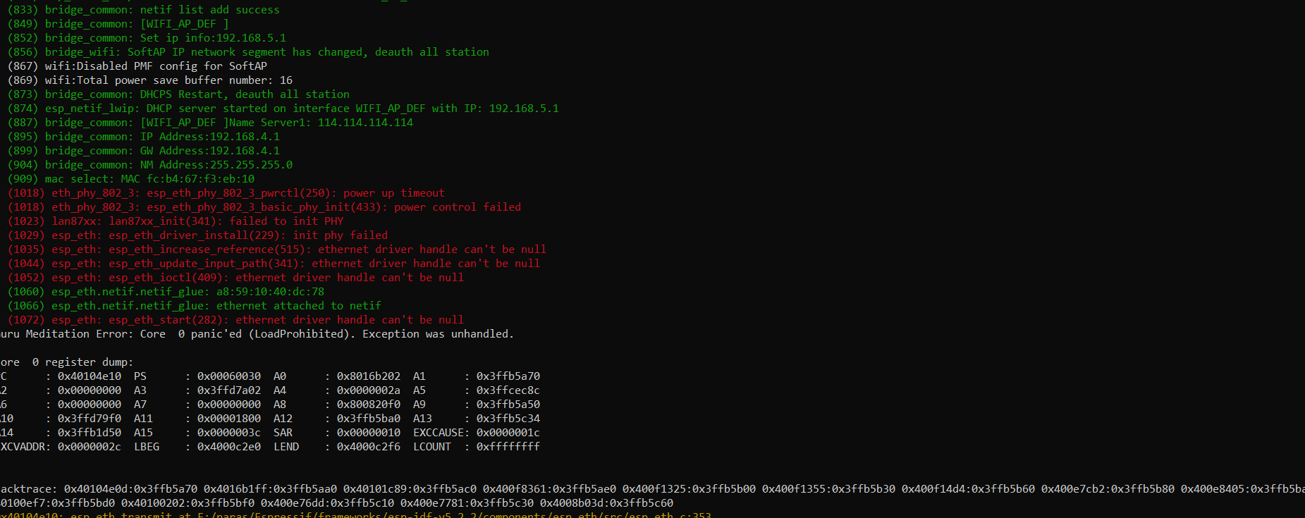

after making some changes for "error, init mac failed" using menuconfig I am not getting that error anymore but facing some new error
E (1018) eth_phy_802_3: esp_eth_phy_802_3_pwrctl(250): power up timeout
E (1018) eth_phy_802_3: esp_eth_phy_802_3_basic_phy_init(433): power control failed
E (1023) lan87xx: lan87xx_init(341): failed to init PHY
E (1029) esp_eth: esp_eth_driver_install(229): init phy failed
E (1035) esp_eth: esp_eth_increase_reference(515): ethernet driver handle can't be null
E (1044) esp_eth: esp_eth_update_input_path(341): ethernet driver handle can't be null
E (1052) esp_eth: esp_eth_ioctl(409): ethernet driver handle can't be null
I (1060) esp_eth.netif.netif_glue: a8:59:10:40:dc:78
I (1066) esp_eth.netif.netif_glue: ethernet attached to netif
E (1072) esp_eth: esp_eth_start(282): ethernet driver handle can't be null
