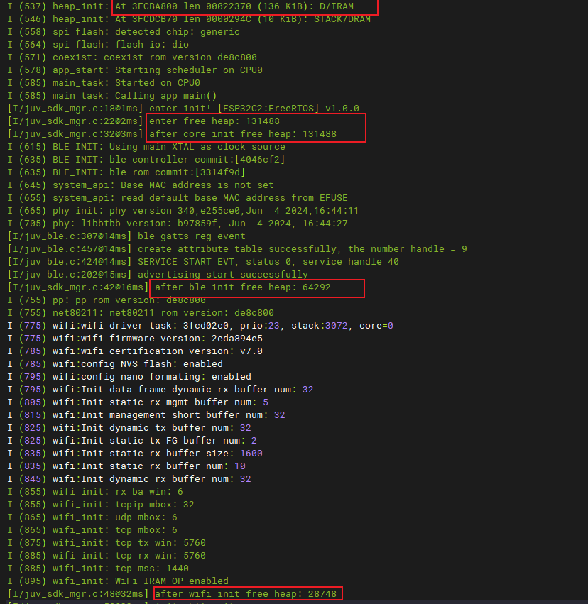

Postby Aliveri » Wed Aug 07, 2024 2:45 am
ble and WiFi functions were added to the firmware, and the initial available ram was only 136k. When the program ble and WiFi initialization are finished, only 28k ram remains. Whether there is room for optimization

Postby Sprite » Wed Aug 07, 2024 3:23 am
Potentially you can go through menuconfig, shrink/lower some of the buffers WiFi/BLE uses.
