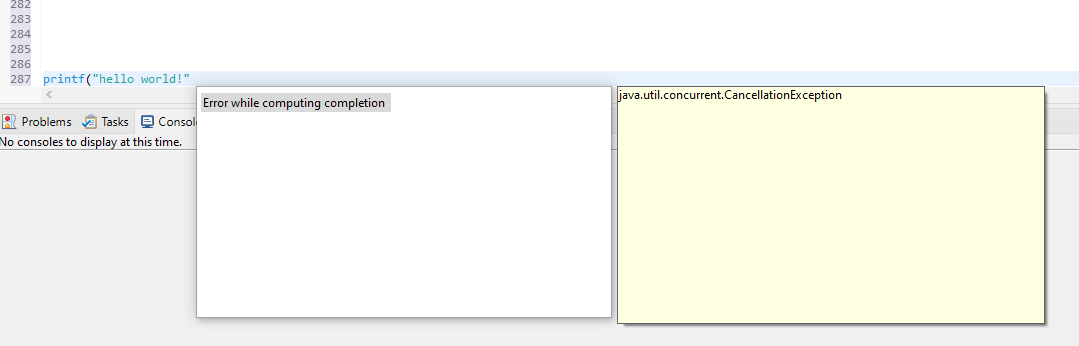

When I initially used Espressif, I encountered no issues. However, after performing a fresh install of my OS, I tried to reinstall Espressif, and found that the tooltip system appears to have broken. Whenever I type within the IDE, I am presented with an error message: "Error while computing completion", with the explanation: "java.util.concurrent.CancellationException". I am using Windows, with IDE v3.0.0, and IDF v4.4.8. I have tried uninstalling and reinstalling, but this does not seem to fix the issue. Any help is much appreciated, as this issue makes navigating the IDE far less convenient. Attached is a screenshot of the error message.

The problem is because of the incompatability of 3.0.0 LSP editor with the IDF v4.4.8. which requires 5.0.0 and higher.
You have two options to resolve this issue:
1. Upgrade to ESP-IDF 5.0.0 and higher
2. Download the required clang toolset as described here https://github.com/espressif/idf-eclips ... 2227979245 and continue to work with the IDF v4.4.8

We have identified that the esp-clang tool was not packaged with the installers. We will provide updated installer builds with a fix soon.
Workaround:
- Open the ESP-IDF Manager in the IDE.
- Remove the currently selected ESP-IDF version.
- Re-add it. This will detect any missing tools and install them again, including esp-clang.
