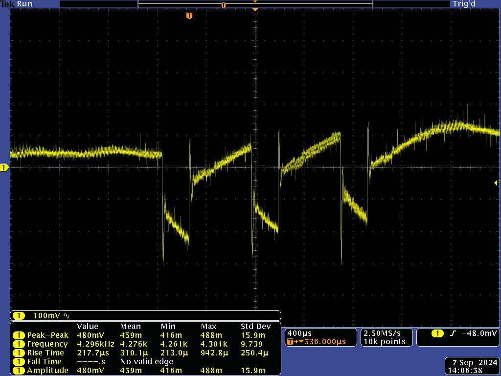

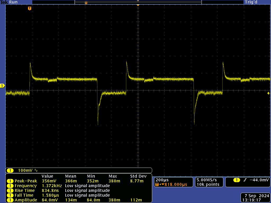

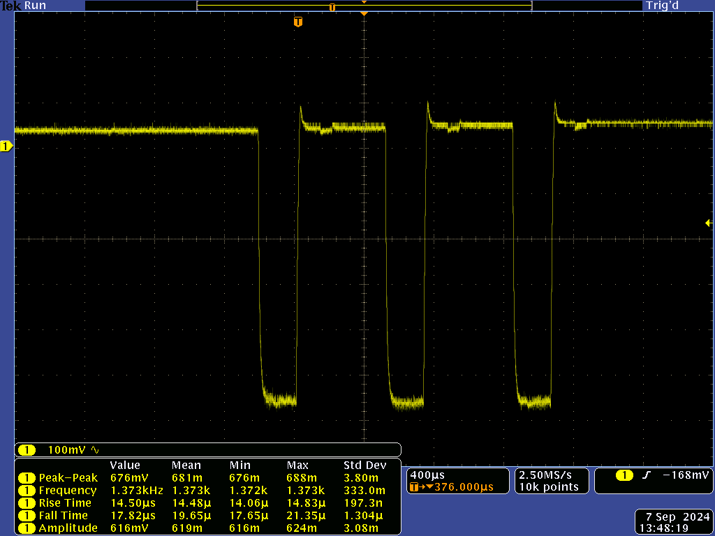

I then checked the power rail with an oscilloscope, and saw periodic ripple when bluetooth was active. I see 3 rather large dips, then stable, then dips again. I didn't measure the periode between the dips. The shape and amplitude vary depending on if I draw power from a li-ion battery or USB (both through the same voltage regulator) or directly inject 3.3V from my RD6006 power supply.

FWIW, three brief current spikes of several hundred mA are normal while the ESP is advertising via BLE.
I guess it's not a coincidence, given that BLE uses three RF channels to broadcast the same advertisement message three times each advertisement cycle.
I don't think the power supply ripple is a problem in this case. Although the battery may not be quite up to the task and may warrant a few extra caps...

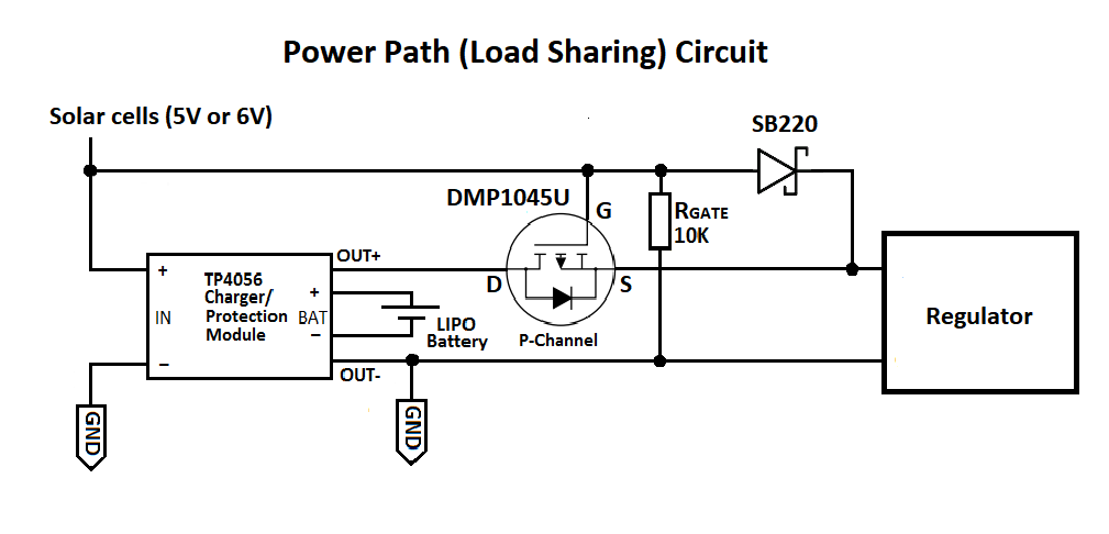

Regarding the battery. I'll definitely try more caps. It could also be the problem that battery goes though a MOSFET but USB goes through a schottky. I have a power path circuit that disconnects the battery when USB power is present. Similar to the attachment.

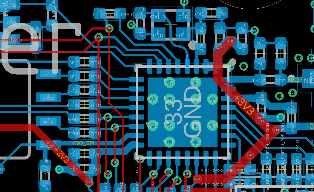

What could be the problem then? I ran XTAL_N under the crystal. Could that interefere?
I attached part of the layout.

I guess the problem is either with the firmware, with Apple's BLE or its configuration, or with the BLE scanner app.
Try another device (Android phone or PC) and see if anything changes.
Do you get any logging output from the ESP?
