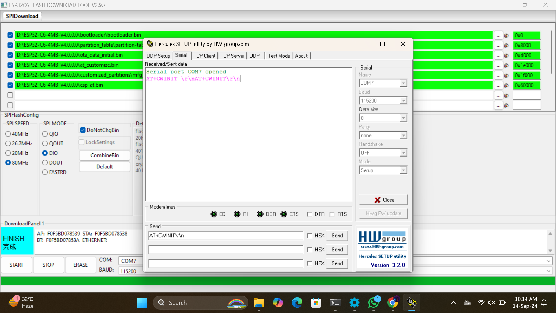

How flash AT comment in ESP32 C6
Postby Mathanmukesh » Sat Sep 14, 2024 4:49 am
Hello everyone i am new to the at comment can someone help me to flash the at comment in the ESPC6 module but i could not succeed can somebody help me
Screenshot 2024-09-14 101435.png (442.55 KiB) Viewed 9721 times
Screenshot 2024-09-14 101333.png (326.98 KiB) Viewed 9721 times

Re: How flash AT comment in ESP32 C6
Postby esp-at » Wed Oct 09, 2024 12:09 pm
it seems that firmware is downloaded ok, but the command you sent, seems to be incorrect.
could you please double check the `\r\n` in command `AT+CWINIT\r\n` are two bytes(CR LF), not four bytes. or you can use another serial port tool. For example, use cutecom on linux, use secureCRT on windows, etc.
