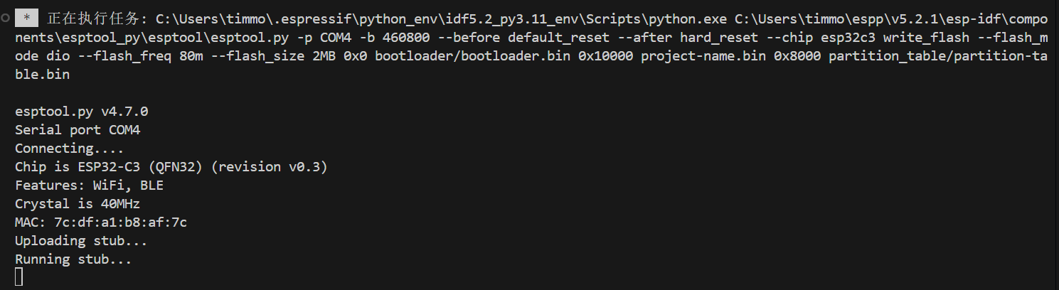

When I flash, the IDF is stay at "Running stub...." without any error, like this:

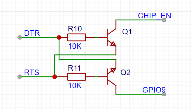

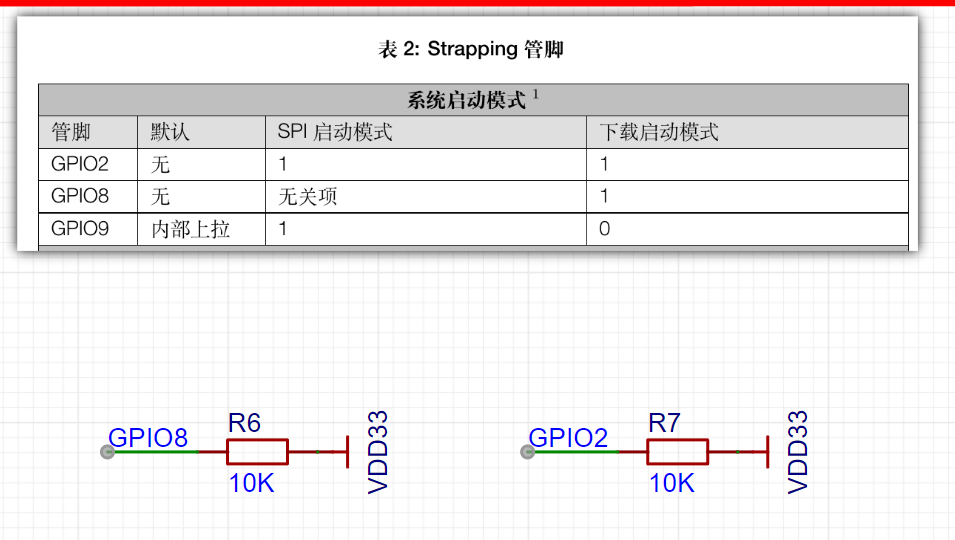

I have pull up GPIO2 & GPIO8, and my board have auto-flash module:
and I have try replace the flash and mcu, but didn`t usefull.
