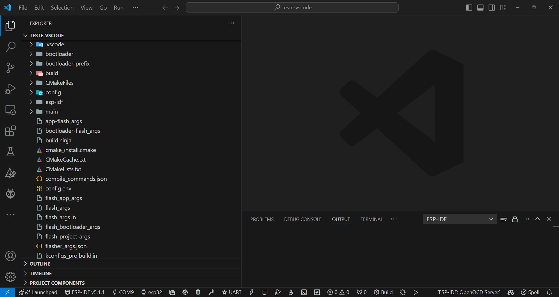

Hello everyone,
After the recent extension updates, I noticed that after the build, several files (which were usually generated inside the build folder) are now being placed in the project's root folder.
How can I prevent these files from being generated outside the build folder?
Captura de tela 2024-09-23 132326.png (131.52 KiB) Viewed 4453 times

Do you have a
"idf.buildPath"
or
"idf.buildPathWin"
defined in your project ? What is the value ?
Make sure to delete it to have default value or use
"idf.buildPath": "${workspaceFolder}/build"
or
"idf.buildPathWin": "${workspaceFolder}\\build"

Postby fabesp » Tue Sep 24, 2024 8:35 pm
Thank you very much, @ESP_bignacio
The problem was the missing backslash in idf.buildPathWin, just as you suggested: "idf.buildPathWin": "${workspaceFolder}\\build"
Now it's working perfectly.
