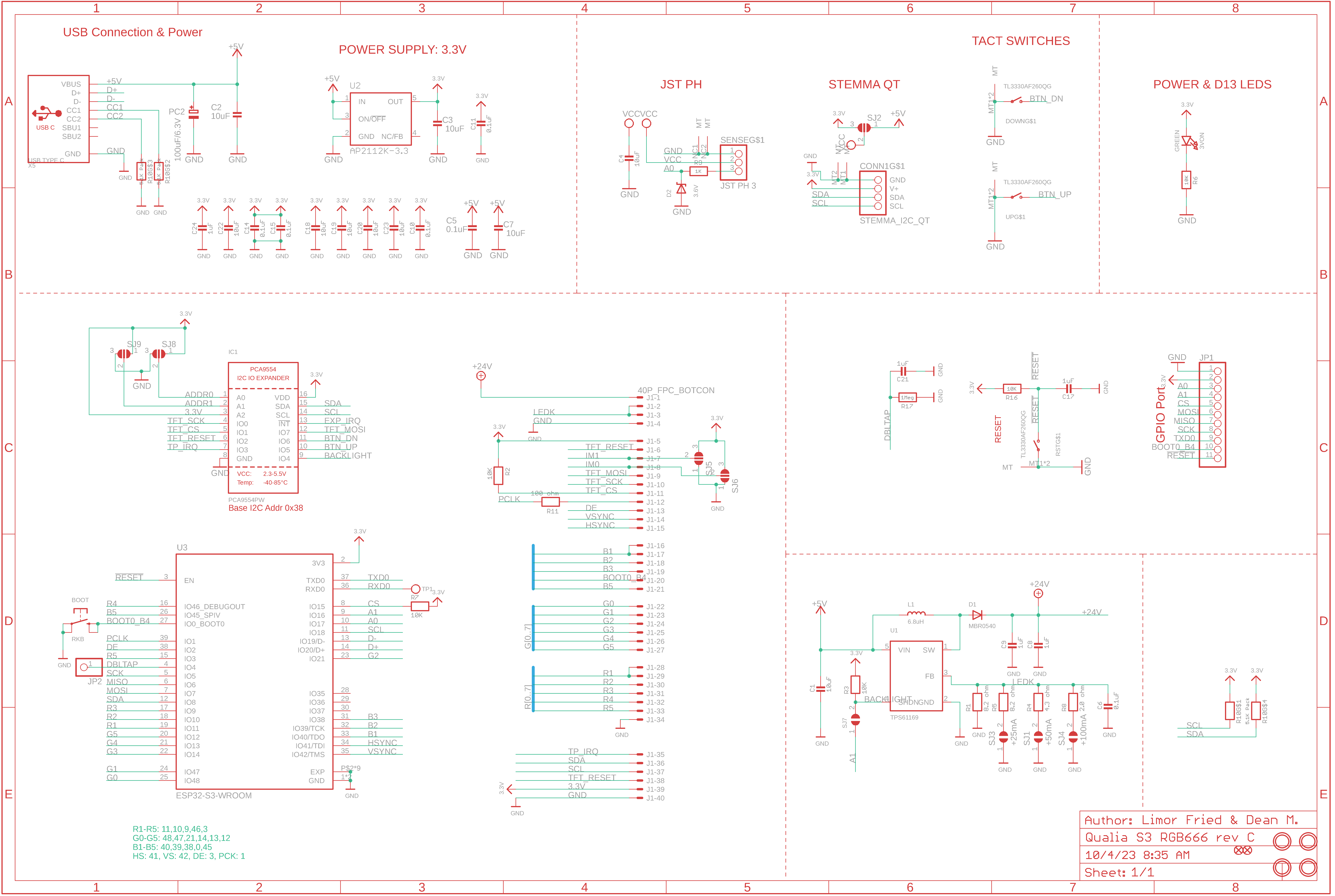

Setup: Driving LCD (without touchscreen) with an Adafruit Qualia ESP32-S3 board which uses a TCA9554 I/O expander. LCD screen uses ST7701 panel driver. Attached schematics show connection between ESP32-S3, I/O expander and LCD screen.
Trying to run the rgb_avoid_tearing example from ESP-IOT-SOLUTION with this setup. For some reason, I'm unable to get a valid io_handle for the I/O expander.

void display_start()
    //Define io_expander handle as suggested in https://github.com/espressif/esp-bsp/blob/master/components/io_expander/
    //esp_io_expander_tca9554/README.md
    esp_io_expander_handle_t io_expander_tft = NULL;
    esp_io_expander_new_i2c_tca9554(I2C_NUM_0, ESP_IO_EXPANDER_I2C_TCA9554_ADDRESS_NEW, &io_expander_tft);
    //Set pin 0 and pin 1 with output dircetion and low level
    esp_io_expander_set_dir(io_expander_tft, IO_EXPANDER_PIN_NUM_0 | IO_EXPANDER_PIN_NUM_1, IO_EXPANDER_OUTPUT);
    esp_io_expander_set_level(io_expander_tft, IO_EXPANDER_PIN_NUM_0 | IO_EXPANDER_PIN_NUM_1, 0);
    esp_io_expander_print_state(io_expander_tft);

This is what my output looks like after successfully flashing the code to ESP32-S3. It goes into panic abort mode.
W (313) spi_flash: Detected size(16384k) larger than the size in the binary image header(2048k). Using the size in the binary image header.
W (327) i2c: This driver is an old driver, please migrate your application code to adapt `driver/i2c_master.h`
I (337) sleep: Configure to isolate all GPIO pins in sleep state
I (344) sleep: Enable automatic switching of GPIO sleep configuration
I (351) app_start: Starting scheduler on CPU0
I (356) app_start: Starting scheduler on CPU1
I (356) main_task: Started on CPU0
I (366) main_task: Calling app_main()
[b]E (406) i2c: i2c_master_cmd_begin(1478): i2c driver not installed
E (416) tca9554: write_direction_reg(134): Write direction reg failed
E (416) tca9554: reset(152): Write dir reg failed
E (426) tca9554: esp_io_expander_new_i2c_tca9554(82): Reset failed
E (436) io_expander: esp_io_expander_set_dir(35): Invalid handle
E (436) io_expander: esp_io_expander_set_level(63): Invalid handle
E (446) io_expander: esp_io_expander_print_state(131): Invalid handle
I (456) display_example: Turn off LCD backlight
E (456) gpio: GPIO_PIN mask error[/b]
Qualia ESP32-S3 schematics showing IO Expander and LCD
AdaFruit Qualia Board Connections to ESP32-S3.png (580.87 KiB) Viewed 17933 times
