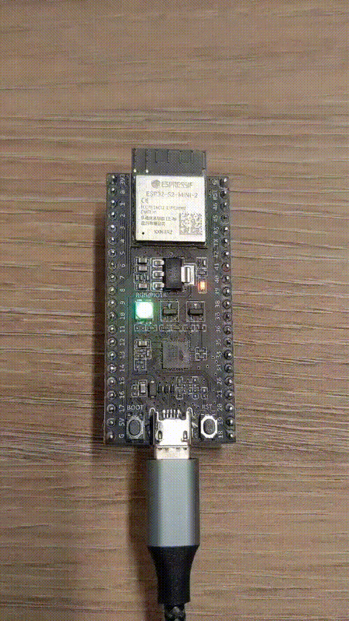

we are using the ESP32-S2 DevKit M1 v1.0 (ESP-S2-MINI-2; `XXN4R2`) and are encountering strange behavior on some of them. Instead of the on-board WS2812 Led going white when told so it will show red.
All of the other primary colors seem to work (red, blue, green).
To rule out any timing/implementation issues we have also done a quick PoC for arduino ide (we are using Rust with `esp-idf-xxx` normally) which has the same behavior.
Running rainbow code
Is this a known fact or something we can do about?

Postby Sprite » Tue Oct 15, 2024 3:19 am
Odd. Might be a PCB design issue: the LED is fed from 3.3V which is at the lower end of its voltage range, and with the LED on entirely the voltage drop over the traces etc may be so large that the power supply to it drops below the forward voltage of the green and blue LED dies. Can you try lowering the intensity a bit (e.g. strip.setPixelColor(0, strip.Color(32, 32, 32));) and see if it works then? If the voltage drop is indeed the issue, I'd expect the LED to turn white with that code.

I tried what you suggested (tested 32, 10 and 1) and all of them are still red, just weaker.
I also powered the board independently instead of attaching it to my PC and still the same result.
On very low power settings i can also see that all 3 color leds are powered, the red one is just brighter than the others.
When comparing the single color pixels to a module which behaves as expected (white led), the red seems to be the same intensity, green a bit less and blue is almost not visible.
Just letting the single blue or green pixel light up (color 0,0,10; 0, 10, 0) the intensity on the "normal" board is noticeably higher.
With some trial and error i could get the LED to be almost white with this color: Color(60, 160, 255)

Feels like somehow the current to the LED is limited by something. In that case, any time the red LED is on, it pulls the supply voltage to below what the blue and green LED need to function. It means that if you e.g. set red to an intensity of 30 and green to 50, the green would effectively only be on as if it had an intensity (50-30=)20.
Unfortunately, I can't replicate it here. The S2-devkit-M1 I have here seems to light up 'white' just fine.
Is there any chance you can post a high-res picture of one of the affected devkits? Could be that something went wrong with the soldering process or something.
