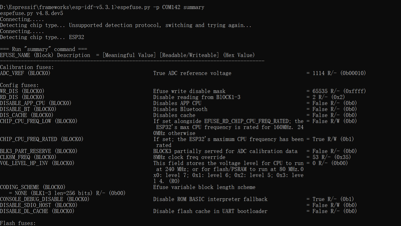

esp32在idf环境下下载不了,或者下载地址为0x1000就不能下载
检查了flash未加密,输出结果为0b0000000
使用espefuse.py -p COM142 summary命令返回结果为:
espefuse.py v4.8.dev5
Connecting.....
Detecting chip type... Unsupported detection protocol, switching and trying again...
Connecting.....
Detecting chip type... ESP32
=== Run "summary" command ===
EFUSE_NAME (Block) Description = [Meaningful Value] [Readable/Writeable] (Hex Value)
Calibration fuses:
ADC_VREF (BLOCK0) True ADC reference voltage = 1114 R/- (0b00010)
Config fuses:
WR_DIS (BLOCK0) Efuse write disable mask = 65535 R/- (0xffff)
RD_DIS (BLOCK0) Disable reading from BlOCK1-3 = 2 R/- (0x2)

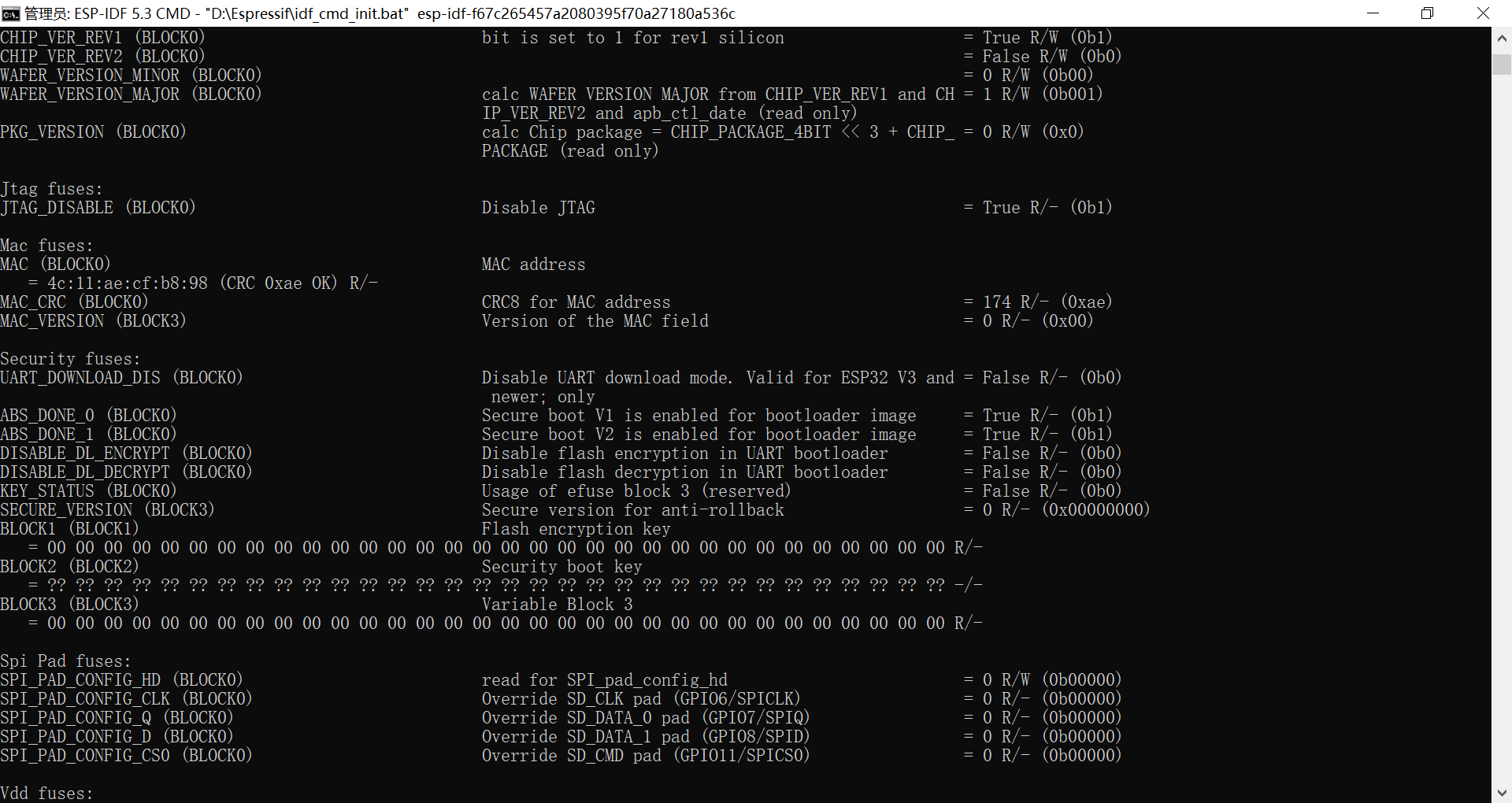

JTAG_DISABLE (BLOCK0) Disable JTAG = True R/- (0b1)
Mac fuses:
MAC (BLOCK0) MAC address
= 4c:11:ae:cf:b8:98 (CRC 0xae OK) R/-
MAC_CRC (BLOCK0) CRC8 for MAC address = 174 R/- (0xae)
MAC_VERSION (BLOCK3) Version of the MAC field = 0 R/- (0x00)
Security fuses:
UART_DOWNLOAD_DIS (BLOCK0) Disable UART download mode. Valid for ESP32 V3 and = False R/- (0b0)
newer; only
ABS_DONE_0 (BLOCK0) Secure boot V1 is enabled for bootloader image = True R/- (0b1)
ABS_DONE_1 (BLOCK0) Secure boot V2 is enabled for bootloader image = True R/- (0b1)
DISABLE_DL_ENCRYPT (BLOCK0) Disable flash encryption in UART bootloader = False R/- (0b0)
DISABLE_DL_DECRYPT (BLOCK0) Disable flash decryption in UART bootloader = False R/- (0b0)
KEY_STATUS (BLOCK0) Usage of efuse block 3 (reserved) = False R/- (0b0)
SECURE_VERSION (BLOCK3) Secure version for anti-rollback = 0 R/- (0x00000000)
BLOCK1 (BLOCK1) Flash encryption key
= 00 00 00 00 00 00 00 00 00 00 00 00 00 00 00 00 00 00 00 00 00 00 00 00 00 00 00 00 00 00 00 00 R/-
BLOCK2 (BLOCK2) Security boot key
BLOCK3 (BLOCK3) Variable Block 3
