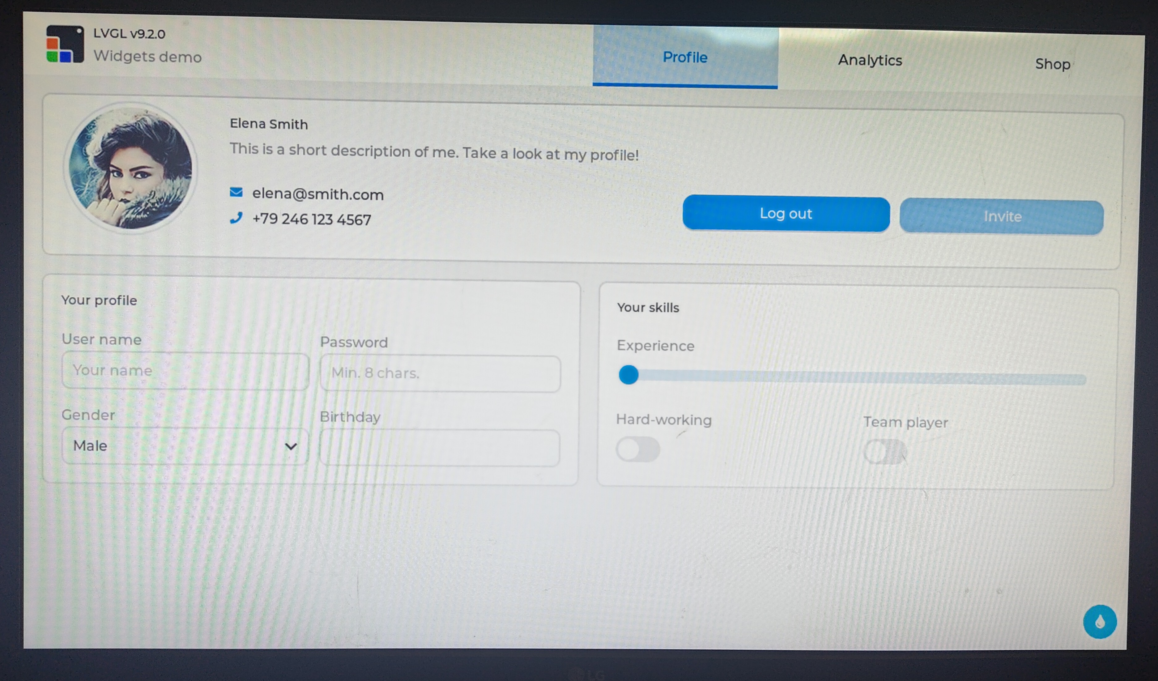

Hello community.
As i mentioned in other topic expressif is making DSI to HDMI extension board and i am the lucky one who have a sample.
Today i made some quick test, nothing fancy, but i would like to share the results.
First of all we have driver code in this bsp branch:
https://github.com/espressif/esp-bsp/tree/feature/hdmi
At the moment we have exposed only one resolution (1280x720x30hz), but no worries, we can find configurations for many other modes (up to 192x1080x60hz)
https://github.com/espressif/esp-bsp/bl ... _lt8912b.h
The simplest example display_usb_hid with connected mouse is utilizing about 12% CPU when have to refresh screen (moving mouse cursor), which is not bad in 1280x720.
I wish you all to get this extension asap and to make some cool projects.
PS here is picture from another demo code (taken with smartphone)

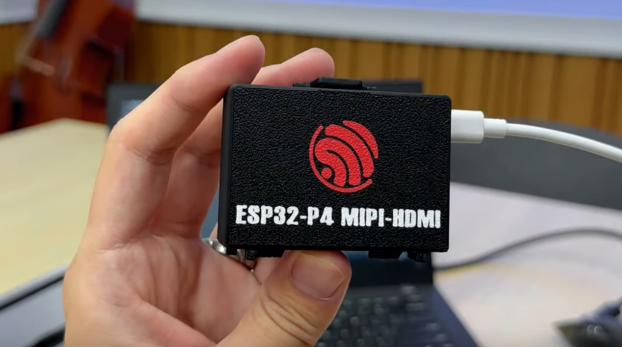

Hi
how cool is this ->
ESP-Demo Mini HDMI Streaming Adapter with ESP32-P4.jpg (146.85 KiB) Viewed 4585 times
Video:
"ESP-Demo: Mini HDMI Streaming Adapter with ESP32-P4"
Project:
"ESP-HDMI-Bridge is a versatile high-definition transmission device designed with the ESP32-P4 chip. It supports wireless screen casting, USB display expansion, standalone multimedia playback, information reception and management. Whether for home entertainment, business presentations, or data visualization, this compact and user-friendly device delivers a stable and high-quality visual experience."

Yes, it is cool.
Sad there is no driverless (actually app-less) solution to extend screen.
Also i wish that someone with passion and better than me can make a driver for this cheap extension to give us full set HDMI to P4 to HDMI
https://www.waveshare.com/hdmi-to-csi-adapter.htm
