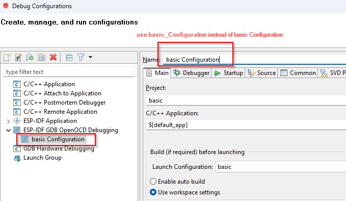

Hi
We are facing an issue with the USB-JTAG interface its not robust at all, every now and then are getting the following error even though there is no build error. "GNU gdb (esp-gdb) 14.2_20240403

Info : [esp32c3] Target halted, PC=0x42000D10, debug_reason=00000000
Error: [esp32c3] no br
Please refer to the troubleshooting guide below to identify the problem.
https://github.com/espressif/openocd-es ... ooting-FAQ
eakpoint at address 0x40388338 found
Error: timed out while waiting

@ESP32 TEAM Could you help me resolve this issue

Hi parthu 123,
I have encountered similar problems in my project. What I can't explain is that, at the beginning, everything worked well. After a while, however, the OCD server could no longer connect to my ESP32S3. After some testing, I discovered that the name of the debug configuration needed to be without spaces. Once I removed the spaces, it worked seamlessly.
regards,
Benedikt
