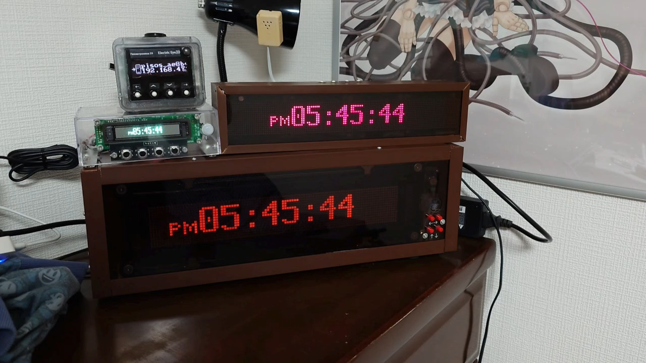

Here are some clocks that I built around the PIS-OS:
From top to bottom those screens are:
1. Vishay/Winstar WS0010 at 100x16: This is an OLED. It's relatively common, but fairly expensive, on Taobao and such. I happened to snatch a lot at Arrow for $5 apiece so now building a bunch of those for friends and family.
2. (Left) Noritake ITRON GU-140x16-7000: vacuum-fluorescent display, which I happened to find new-old stock at Kyoritsu while being in town for Magical Mirai :-) I've also built another one in the WS0010 form-factor with the GU-115x16-7000, but that one was already packaged and sent to a friend who is a die hard fan of the ITRON displays.
3. (Right) Some weird LED panels from Akizuki Denshi's outlet stock, labeled K-875. They were on clearance due to missing rows in some modules, but that was a matter of adding a missing track on the PCB. There are 4 panels daisy-chained for a 128x16 px display, software-driven using the SPI peripheral.
4. The biggest one is the Morio Denki 16101DS plasma display, which used to be used for route indicators in the interior of some Japanese buses. I've come across one by accident, and only ever seen one in a bus just once, so they must be very rare. It's basically like an array of 101x16 nixie dots and has to be driven with a very high voltage (160V+). Luckily the module has a framebuffer on it which makes things easier. Here is a small demo video with a very early version of the firmware: https://youtu.be/D4MiHmhhjeQ
