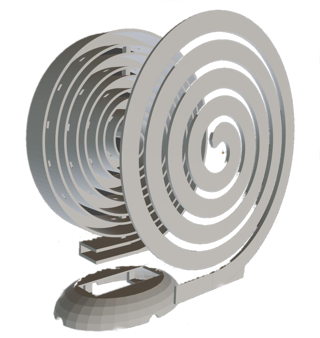

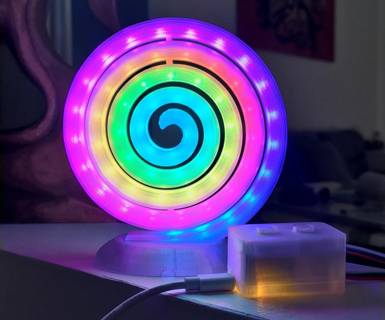

Archie is a fully featured DIY and open source Smart Light with the following features:
- works on ESP32 / ESP8266
- two local buttons to access main functionality
- easy WiFi connection using either WPS or Bluetooth
- integrated Automation Scheduler that supports Cron and JavaScript!
- soft dim/bright/color animations @100Hz
- selectable color light effects
- strobe effect
- highly configurable: LED types, number of pixels, ...
- free mobile app to control and program it
- music-synchronized effects with "party mode"
- open source API
- open source Firmware (HomeGenie Mini)
- firmware can be uploaded to ESP directly from the website
- simple controller PCB (Gerber files included)
- 3d printed casing (3MF files included)
.. documentation and files available on the official website.
