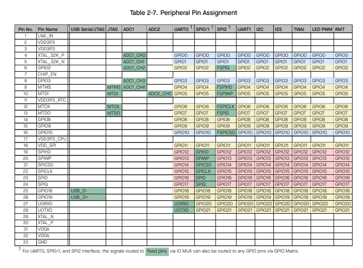

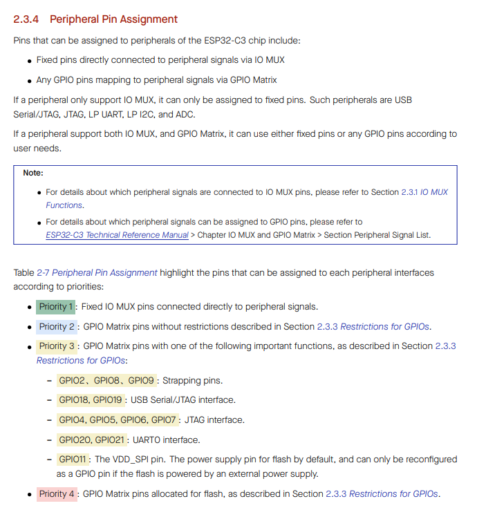

Hello everyone,
We’re excited to announce that the ESP32-C3 Datasheet has been updated with a brand-new section titled "Peripheral Pin Assignment". This section has been introduced to provide a clear and structured overview of the pins that can be assigned to each peripheral interface, categorized by priorities.
What’s New?
  • Clear priority-based pin assignments:
    Priority 1: Fixed IO MUX or LP IO MUX pins directly connected to peripheral signals.
    Priority 2: GPIO Matrix pins without restrictions.
    Priority 3: GPIO Matrix pins with critical functions (e.g., JTAG, UART, strapping pins, etc.).
    Priority 4: GPIO Matrix pins allocated for off-package flash.
  • Detailed Notes if a peripheral supports IO MUX only, GPIO Matrix only, or both
  • Tables for quick reference
Why This Update?
This new section is designed to help:
  • Quickly understand which pins can be assigned to specific peripheral interfaces.
  • Learn about restrictions and limitations for certain GPIOs.
  • Learn if the pins might be occupied by other peripheral interfaces.
