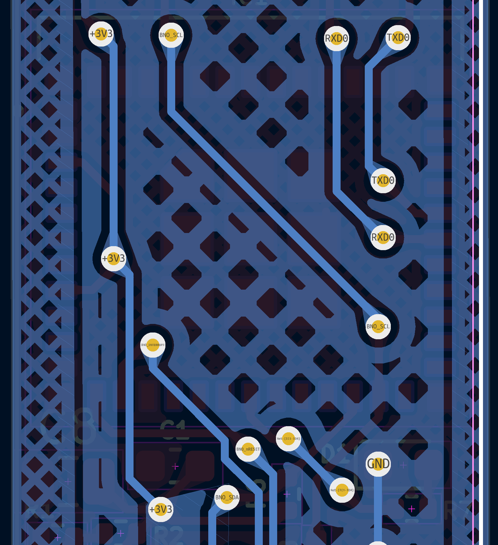

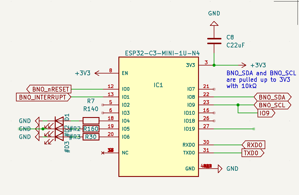

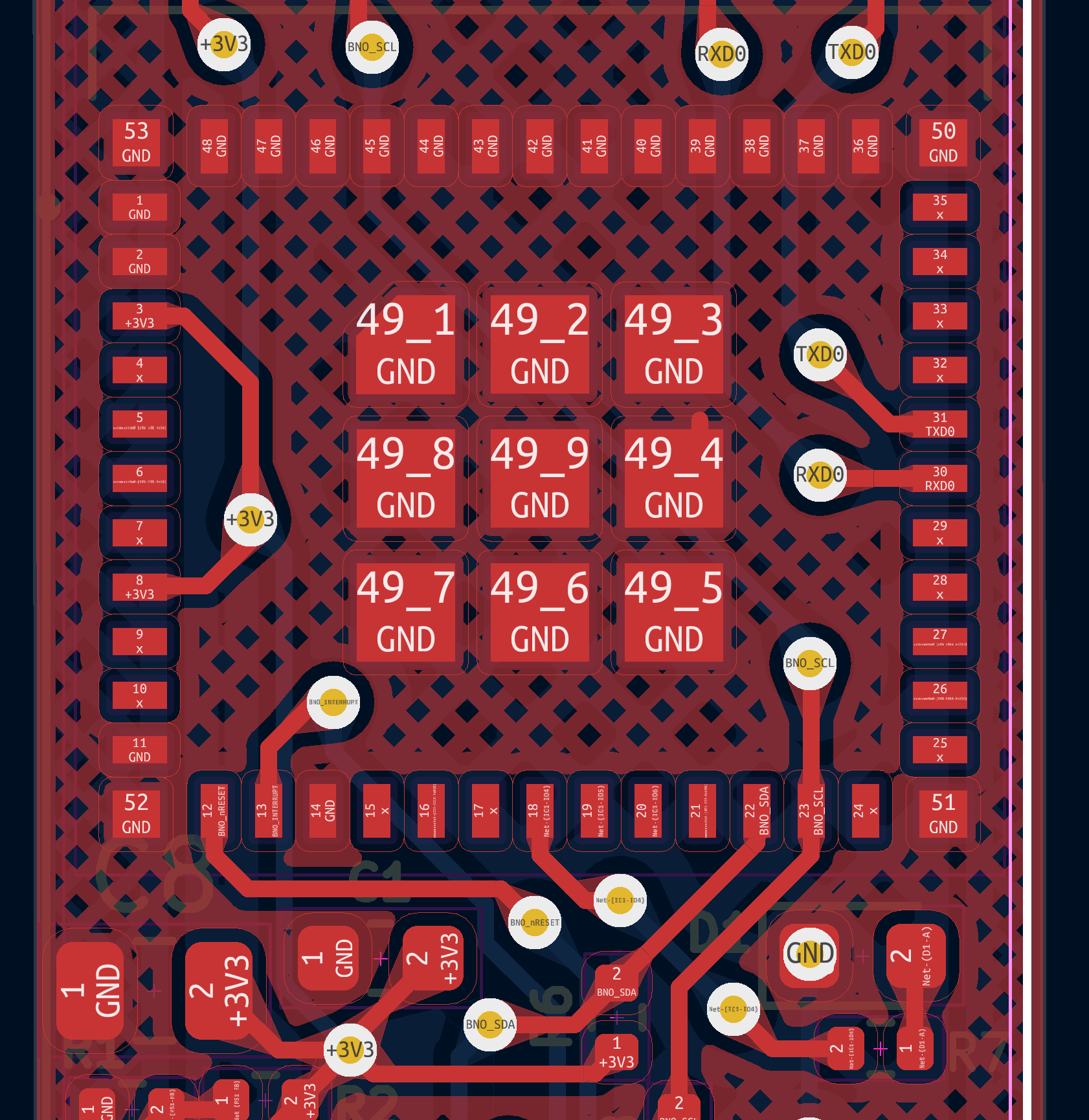

<t>Hello,<br/>
<br/>
I have this design for a custom PCB (attached the electrical schematics and the layout).<br/>
The PCB is a flex PCB, so it's really thin, with a stiffener below the ESP32.<br/>
<br/>
Unofrtunately, despite seeming to be powered on (the board draws about 14mA when powered, versus 5 mA with the ESP32 unsoldered), I am not able to program the board. I am using a standard USB-to-UART external converter which works just fine with other boards with the same chip.<br/>
<br/>
I event tried to attach an oscilloscope probe to the exposed TXD0 and RXD0 pin. When powered, I get no signal on the TXD0 pin, while I would expect the chip printing the same message as nothing is found in flash memory, so it should be rebooted continuously (at least this is what was happening with other boards). Similarly, when uploading the program, I get no confirmation from the board and the uploading fails.<br/>
<br/>
The only differences I had with this board versus other boards are the following:<br/>
- The substrate is not FR4 but polyamide, but I have X-Ray analysis of it and solder joints seem fine.<br/>
- I swapped the I2C interface from GPIO9/GPIO10 to GPIO8/GPIO9. I know GPIO8 and GPIO9 are strapping pins, but they are both pulled up. I can bring GPIO9 to ground by closing a couple of jumpers to enter download mode, but still I can't get the traditional "waiting for download" message on UART (no signal on UART whatsoever).<br/>
<br/>
Could it be that, since the power converter takes a while to bring the voltage to 3V3, the GPIO8/9 are seen as floating?<br/>
It is strange tough, because I know there is a bit of slack between when the chip wakes up and the reading of the strapping pins. It is also true that the strapping pins are pulled up by a resistance, but the EN/3V3 pins are not. Also, the board has the same behavior when supplying directly 3V3 (instantly, without any conversion).<br/>
<br/>
Should I go back to using GPIO9/GPIO10 instead of GPIO8/GPIO9? Am I right in assuming that on power-up I should see something printed on the UART TXD0 line?</t>

Postby Sprite » Fri Nov 22, 2024 2:11 am
You cannot connect EN directly to Vcc; it needs a power-on reset network. Please check the hardware design guidelines for more info.

I understand what you are saying, but before re-ordering a new board with the fixed RC circuit for the EN pin, I want to make sure there's no other issue in the board. I think that there could be something else, since there is a previous designed (printed on an FR4 substrate, while this one is on a flex substrate) that worked flawlessly (I was able to enter/exit download mode by manually pulling the pin HIGH or LOW before powering the chip).
Also, would the UART be functional, the worst I can get (I guess) is that I enter the wrong boot mode. But I get no UART output at all! Maybe there's some caveat in using the GPIO8/GPIO9 as I2C pins as well as bootstrapping pins?
