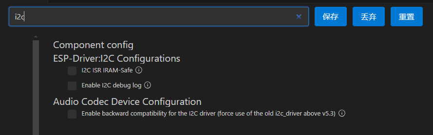

esp_hmy39
Joined: Fri Jan 03, 2025 9:06 am
Re: i2c conflict esp-rtsp sample code
Postby esp_hmy39 » Fri Jan 03, 2025 9:11 am
Uncheck this option.
aldonubilo
Joined: Fri Nov 29, 2024 8:34 pm
Postby aldonubilo » Fri Jan 03, 2025 4:07 pm
Code: Untitled.txt Select all
With the suggested configuration the problem is still present;
as already described we are using esp-idf-v5.3.1 and current version of esp32-camera component (2.0.15 automatically downloaded during first build) is still using old i2c driver for IDF < 5.4 (Please see at CMakeLists.txt of esp32-camera component line 85)
# include the SCCB I2C driver
# this uses either the legacy I2C API or the newwer version from IDF v5.4
# as this features a method to obtain the I2C driver from a port number
if (idf_version VERSION_GREATER_EQUAL "5.4")
list(APPEND srcs driver/sccb-ng.c)
else()
list(APPEND srcs driver/sccb.c)
endif()
