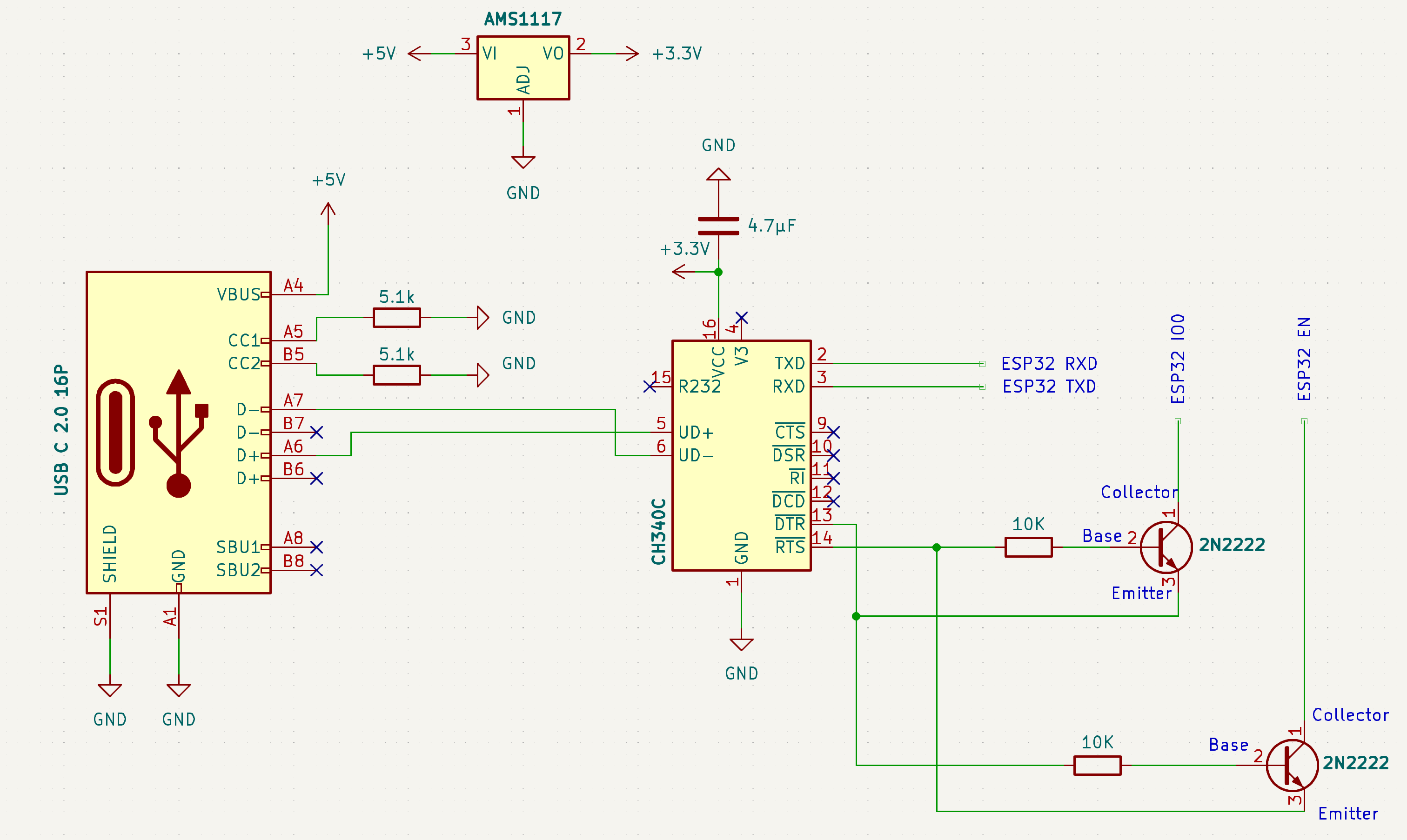

Here is my schematic (simplified in order to only show connectivity between USB C, CH340C and ESP32 WROOM E).

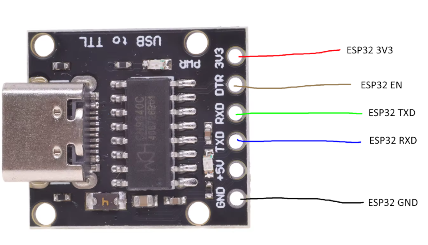

When I saw that my sketches wont upload (It recognized the ESP32 module, but I got this error : "A fatal error occurred: Failed to connect to ESP32: Invalid head of packet (0x65): Possible serial noise or corruption."), I tried to create a small prototype just to upload sketches using an USB C and CH340C module, here is the schematic I got from Chat-GPT :
But when I try to upload my sketch, I get the same error as the first one. I can't find the documentation of the module "USB C and CH340C" so impossible to see if what I am doing is correct...

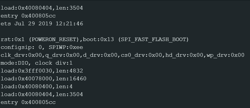

When I open Serial Monitor on Arduino IDE and I plug my PCB, I get this :
Strangely, I discovered that if I connect EN to IO23 using jumpers while uploading, it seems to work, and I can get a working Serial.print reading. But if my sketch is too big, I get "A serial exception error occurred: Write timeout" using this technique. I guess it is not a solution, but I feel I had to let you know.

Is the ESP32_EN line connected to anything else besides the ESP32-Wroom-E? (You need a RC network on it as well, if not the ESP won't get a good power-on reset and probably will reset at random times.)
Re: Problem with custom PCB with ESP32 WROOM E and sketch uploading
On the USBC connector. You didn't connect both A7 & B7 together, along with connecting both A6 & B6 together. If you dont make these contentions when you flip and re-insert the USB-C cable it wont work.
Or you can just use the ESP32-S3 chip and avoid all that extra hardware

EN of ESP32 is connected to nothing else but the collector of a transistor.
I have seen schematics using RC network (for newbies, it means resistor and capacitor network. It ensure a stable power-on reset), and other not using it. I doubt this is the reason of my problem but I may be wrong.

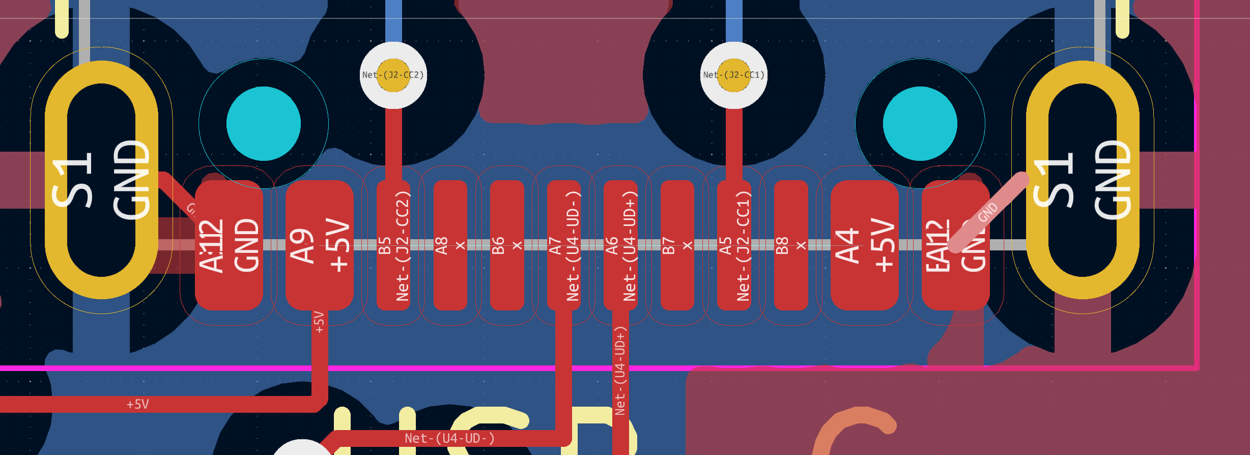

You are right, if I flip my USB-C, it is not detected by my PC anymore. This is my current USB-C connection :
We can see my A7 pin is D+, which I need to connect to CH340C D+. But I have floating A8, B6, B7, B8. Do you think this could be the problem ?

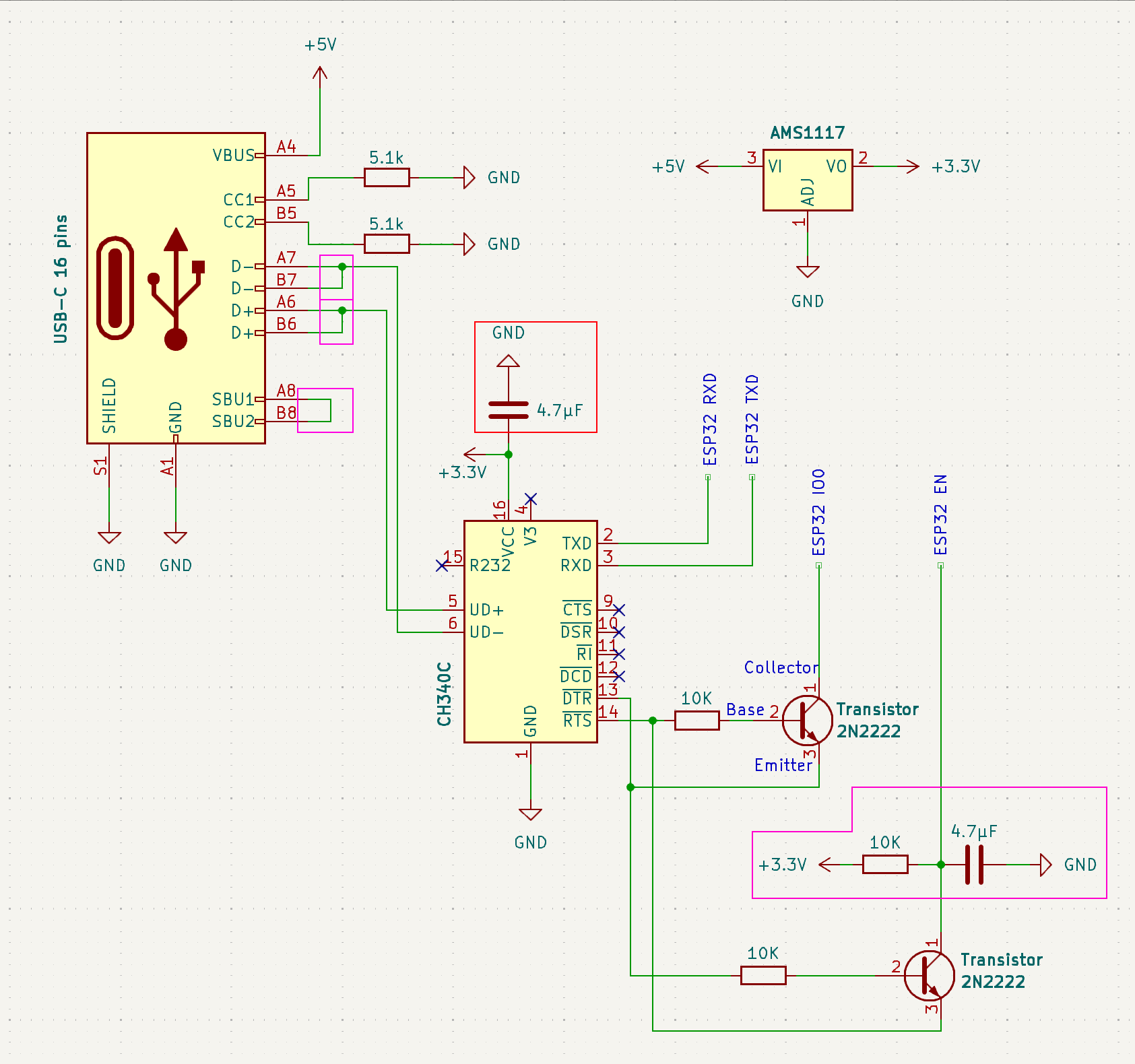

You need the RC for a power-on reset, but the R also has the secondary effect of pulling the EN pin up to a defined level (3.3V). If you don't do that and have nothing else on the line that does something similar, you're getting weird behaviour. In general, all ESP32 schematics must have either the RC network or something similar (e.g. dedicated voltage monitor) to work properly.@ESP_Sprite

I'd suggest adding a RC network to the EN pin and seeing if that solves the issue.

No, because you can see info from the terminal. But if you plug in the USB cable 180 Deg you wont.We can see my A7 pin is D+, which I need to connect to CH340C D+. But I have floating A8, B6, B7, B8. Do you think this could be the problem ?

Well, I added a RC network and it worked. As I did it "quick and dirty" in order to test, I sometimes get a write timeout error, but it eventually works. I would think that if I include this part to my custom PCB, it would work every time. A big thank for this helpful answer.
@username
This would be really nice if I could have both USB-C sides working when I plug it.
To be sure that I can upload my sketches on the new PCB I will order soon, and that it will work on both USB-C sides, I post my new configuration. If you have any comment / piece of advice about my schematic, I will read it with pleasure.
Pink zones is what I added. Not really sure for the connection between SBU1 and SBU2 on USB-C.
For the red zone ; is it mandatory to keep this part ?

You really need some caps on the input and output on the 3.3v regulator.
you should put a 0.1uf & at least a ~10uf on the input. The 0.1uf should be as close to the input pin as possible.
The same should be done on the output as well.
You should also add a 0.1uf to pin 16 of the CH340.
