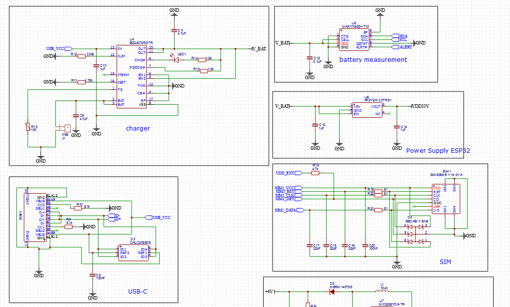

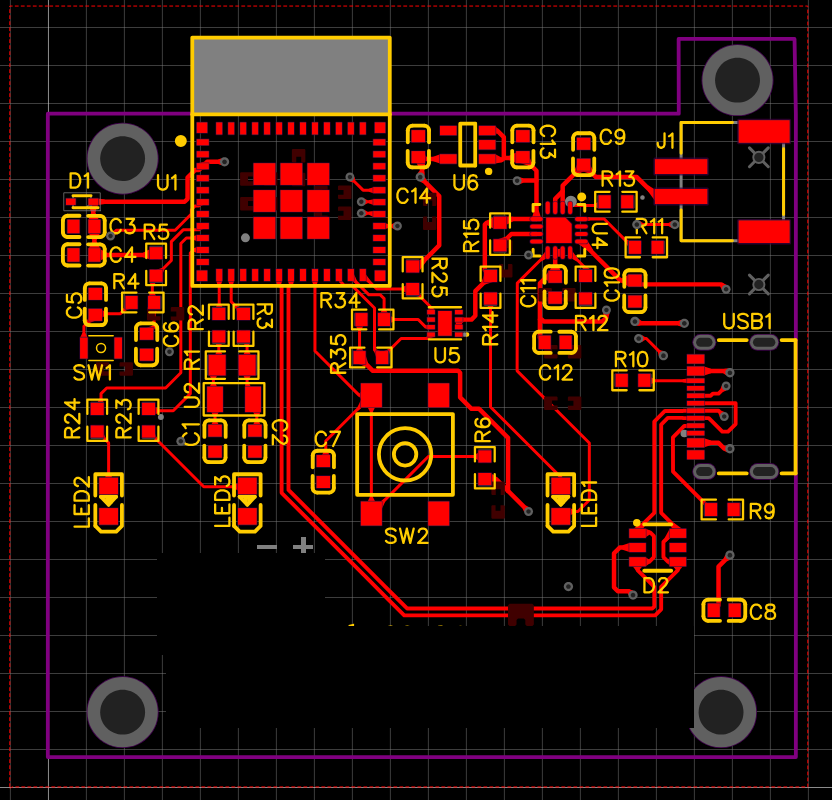

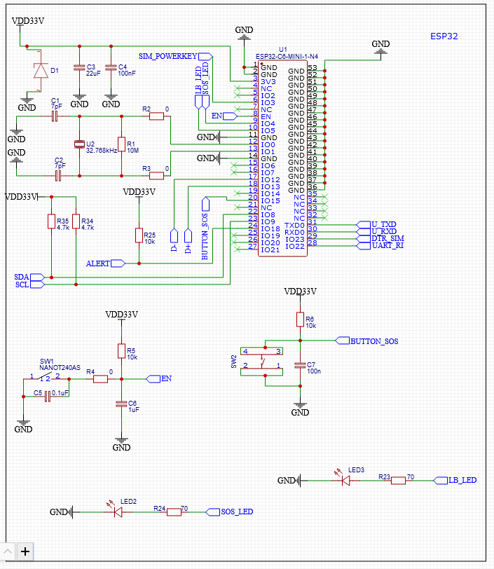

I have a problem with the detection of the module in esp32 (ESP32-C6-MINI-1-N4) in the device manager.I created my own PCB everything is well soldered,I checked the voltages in the right places and they appear to be correct.I have a suspicion that this situation may be due to the fact that to the pins IO9 and IO8 are connected SDA and SCL lines.
I am attaching the schematic and PCB below.

Looks OK at first glance. Can you see if there's any serial activity on TX0 when you reset the module? If so, what does it say? Also, can you try forcing GPIO9 low and resetting it, see if it shows up then?

Thanks for the answer.I tried to force GPIO9 low and reset but nothing happened.As for checking the serial activity it's hard for me to check because the computer doesn't detect the COM port and I don't have an oscilloscope to check if there is any activity there.
