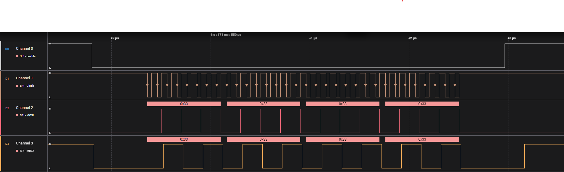

With the ESP configured as a slave, and restarting it, its first SPI transaction it receives is "wrong".
The data received is wrong, and the data it transmit is wrong.
All subsequent transactions have no problems receiving or sending.
Both the master and slave are transmitting 4 0x33 bytes.
After investigating with the logic analyzer, the only problem seems to be the firs transaction's MISO data.
All other transactions look fine on the logic analyzer.

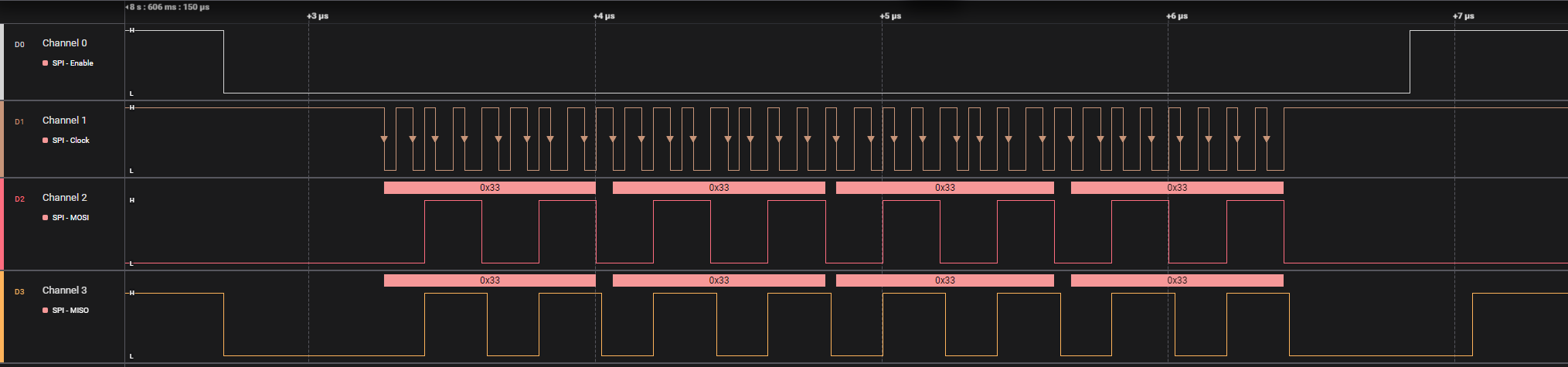

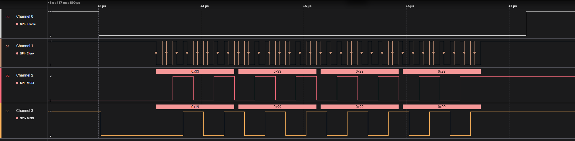

And here are the three SPI transactions on the logic analyzer:
First Transaction:
First SPI Transaction
Second Transaction:
Second SPI Transaction
Third Transaction:
Third SPI Transaction
