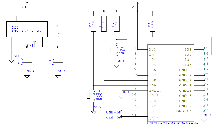

The most basic test setup I'm using is:
* EN pulled up to 3V3 with 10k and decoupled to GND with 1uF, with a microswitch used as RST button.
* GPIO2 + GPIO8 pulled up with 10k to 3V3.
* GPIO9 pulled up to 3V3 with 10k and a microswitch as 'BOOT' button to GND.
* 3V3 from an AMS1117 (fed by 5V USB VBUS). Decoupled on both 5V and 3V3 side with 4u7 ceramic cap.
I have a feeling I'm overlooking something very basic/fundamental, but for the life of me, I can't figure out what it is. Any suggestions of things I can try would be welcome.

Example 'skeleton' bare bones schematic
ESP32-C3 USB skeleton.png (39.02 KiB) Viewed 3743 times

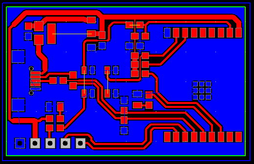

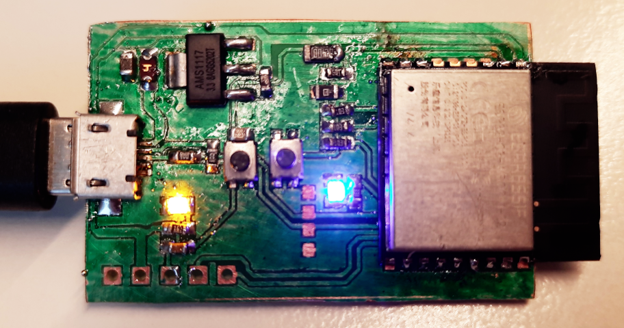

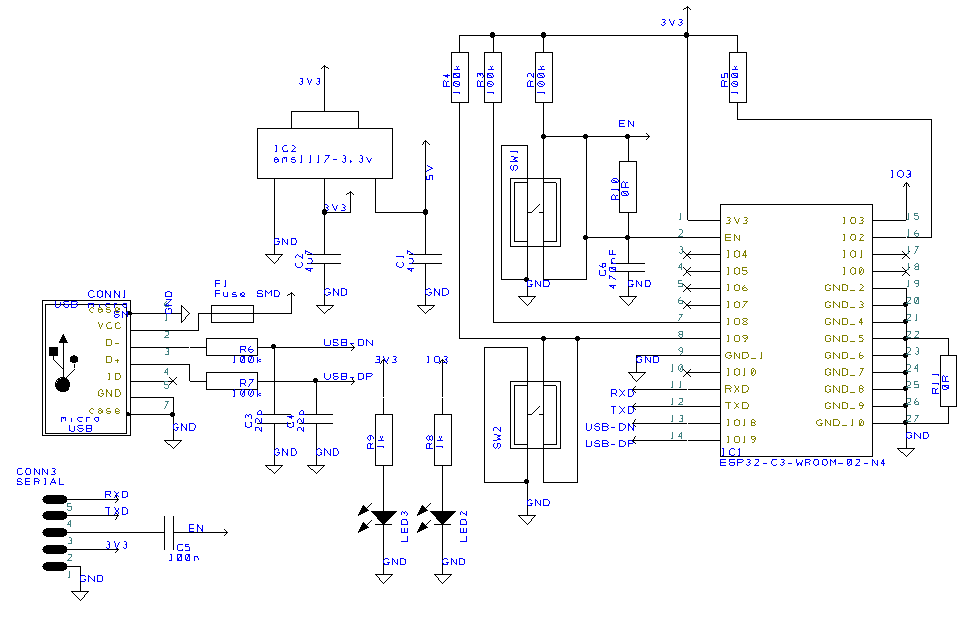

However...yesterday after posting this thread I did one 'final' experiment to put my mind at ease. And guess what...it works like a charm. I think the problem has been poor physical layout all along. Apparently the ESP32 is just more sensitive to this than devices like CP2102 and CH340. The tests I had done before involved boards that required small, manual bug-fixes and entirely handmade contraptions, in the expectation that USB would be rugged enough to at least enumerate under less than ideal conditions. I suppose that it really isn't and layout is every bit as critical as all documentation out there also suggests.
I've included the schematic, PCB layout and a photo of the working test setup. It looks a little shoddy because it's a handmade PCB that I made while dinner was cooking.
Note that the capacitors that decouple USB-DP and -DN are not populated as per ESP documentation. The series resistors in both data lines are 10R.
Pullups on EN, GPIO2, 8 and 9 are 10k. The capacitor between EN and GND is 470nF. I don't think any of these values directly affect USB enumeration although I can imagine that making the cap too small (or leaving it out) can result in a brownout condition as power comes on, making the startup (and USB enumeration) less reliable. However, I had previously already excluded this in earlier tests.
So my conclusion remains that all my earlier setups suffered from (too) serious physical/layout problems.

OK, that was quicker than I anticipated. On the original board I did most testing with, there was a provision for a separate USB-UART bridge (a 'just in case' addition for prototyping) that I didn't end up using in the prototype. However, it did have traces for USB-D+ and D- routed to the unpopulated footprint from the USB connector. Having learned that the routing is a little more critical than I had anticipated, I cut those 'spare' traces on one of the proto boards...and the USB came alive on the ESP32. Apparently, the effective T-shaped traces picked up noise or created reflections (I suspect the latter) that spoiled the broth.
What still puzzles me is that in another setup that I manually wired and that did not feature a similar T-shaped trace pattern with dangling ends, the problem also existed. So maybe the coathanger approach is a little too optimistic.
